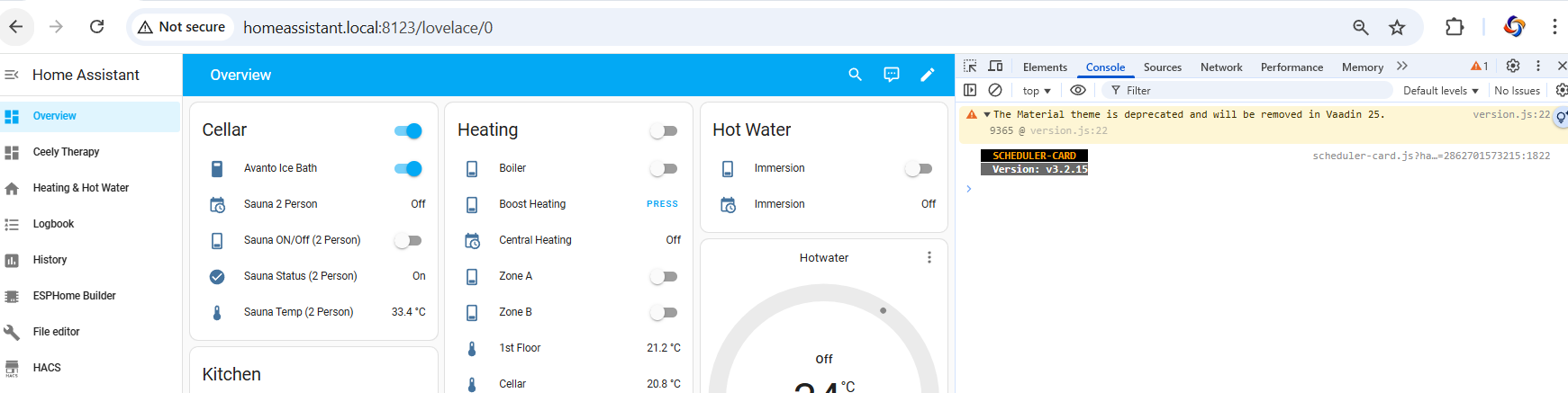

Hi I installed schedule component and schedule card but cannot see the Card. Have looked af previous post on this but I can see the .JS file. There was also a GZ in the folder and I have deleted it.
I have a number of dashboards and wondering if this is causing the problem. I can see the card version number in the browser console SCHEDULER-CARD Version: v3.2.15

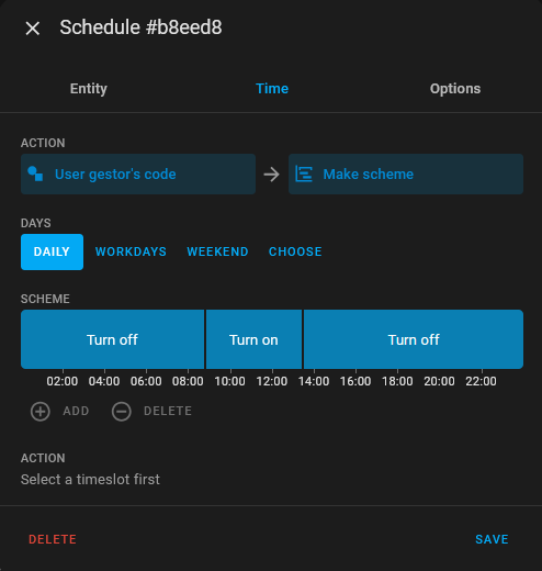

My questions are about this screen here:
  1. What is this called? It’s a basic question, but I see display options and customizations options, but they’re for the main screen, not for this screen in which we edit a specific schedule… perhaps I would find more if I knew what people call this…
  2. Can I change or hide that ugly Schedule #b8eed8 on the top? Where is that coming from?
  3. Can I hide that Entity tab near the top? I don’t want non-technical users to see that, and much less change things in there…
Thanks in advance for any help! :+1:

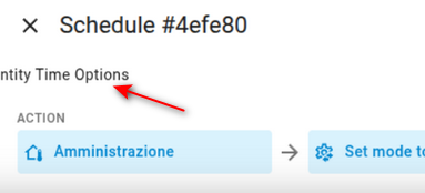

I did study the documentation, but where is the option tab? In the documentations there is this ā€œoptions panelā€, but I can’t see where it is.
Am I dumb because I can’t find it in my HA and in the documentation? Say it, it’s not a problem, I can be, but please tell me where to find it because every 2/3 weeks I try to change the names, I search on the Internet and in this forum and I always end up abandoning the idea.
Have installed both, the intergration and the card?
Yes, I did

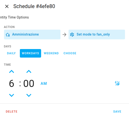

@andrex please see this Bug I filed recently:
I also notice that something is not correctly rendered in your card, some CSS problem:
You have the options tab there, but it doesn’t look like a proper tab, and maybe for that reason you can’t click it?
@pgr thanks for your kind reply.
I see the word ā€œEntiyā€, ā€œTimeā€ and ā€œOptionsā€ up in the left corner, but if I click on any of those nothing happens.
Yeah, see if you can update any cards or HASS components, restart HASS, hit refresh, try a different browser… your card doesn’t seem to be loading properly/fully.
I guess you did hard reload ? Not just F5…
I was behind some months on the HA updates, I’ve done that and it solved my problem :man_facepalming:
Thanks for the support, especially to those that didn’t feel the need to judge!
