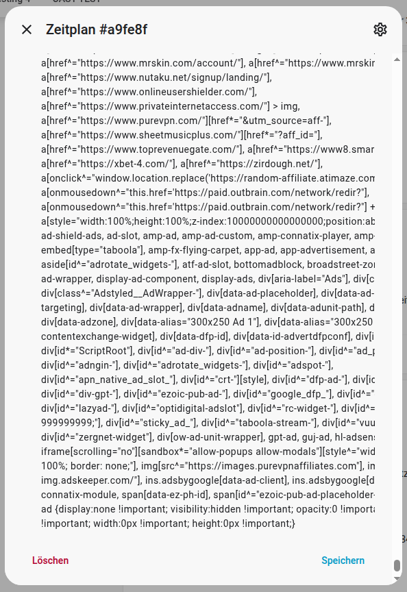

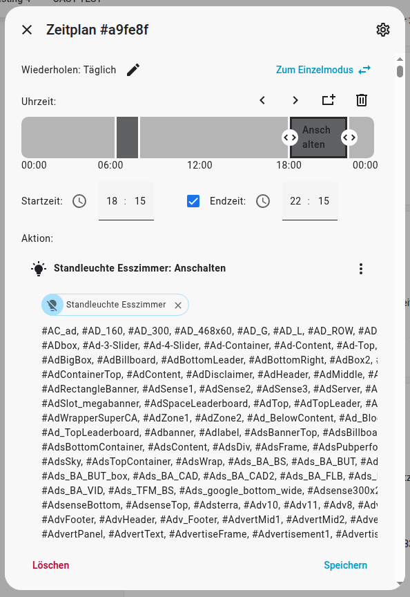

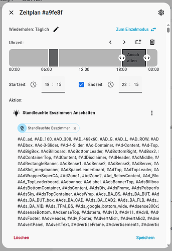

Hey there, is this normal?
Looking somehow compromised to me…
Cro.
There just was an update to scheduler. Try it out and report back please.
same, there just was an update…

I had the same issue. Found out that the ad blocker in chrome was the root cause. Regards Christoph

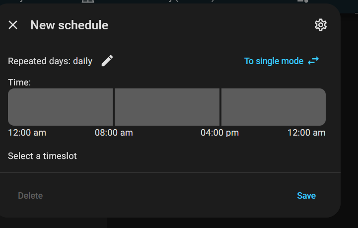

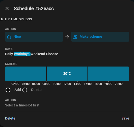

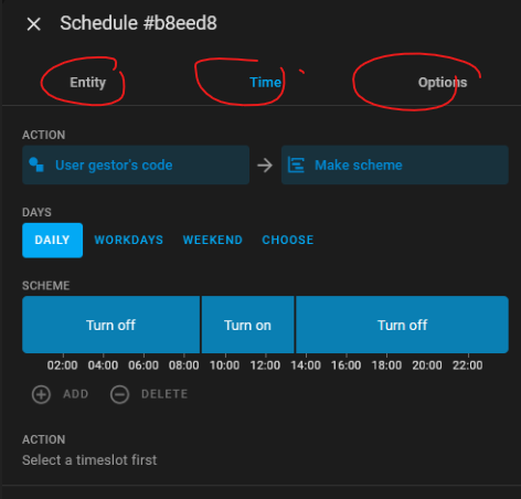

Hi there!
is there a reason why I see this layout during the setting of a schedule instead of the one you posted above?
I cannot rename it and select the other options!
Don’t know what happened! A few times ago, it was working correctly!
I’ve already tried to remove and reinstall the schedule!
Thanks in advance!!
Dears, any idea why my card is broken? When I hit Add from a Scheduler Card I get this screen instead of what I was used to
Edit: I see there was an update though it seems it lost a functionality like to operate with groups/multiple entitites…
I think it’s the same problem that occurred to me! (Message above).
