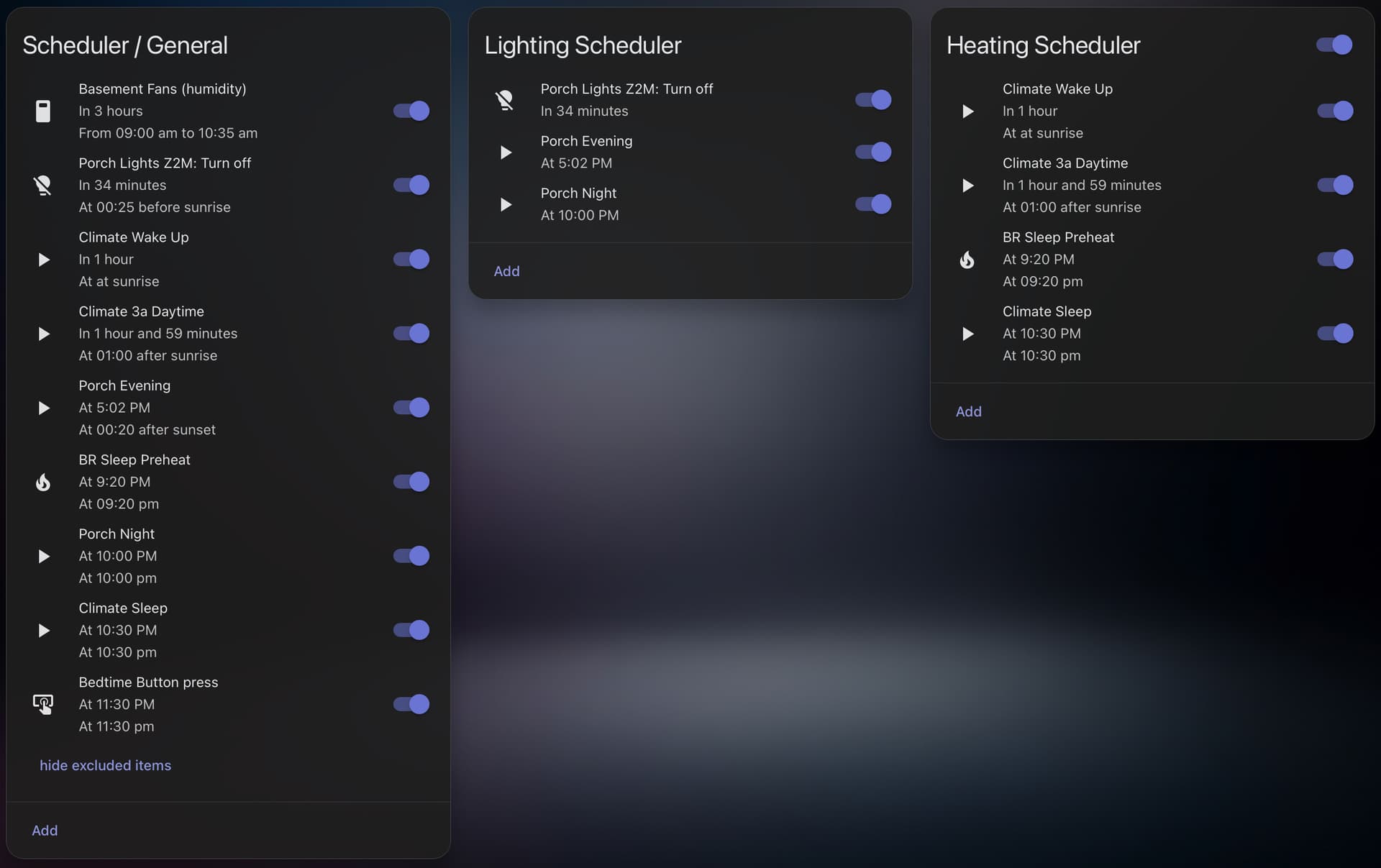

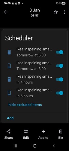

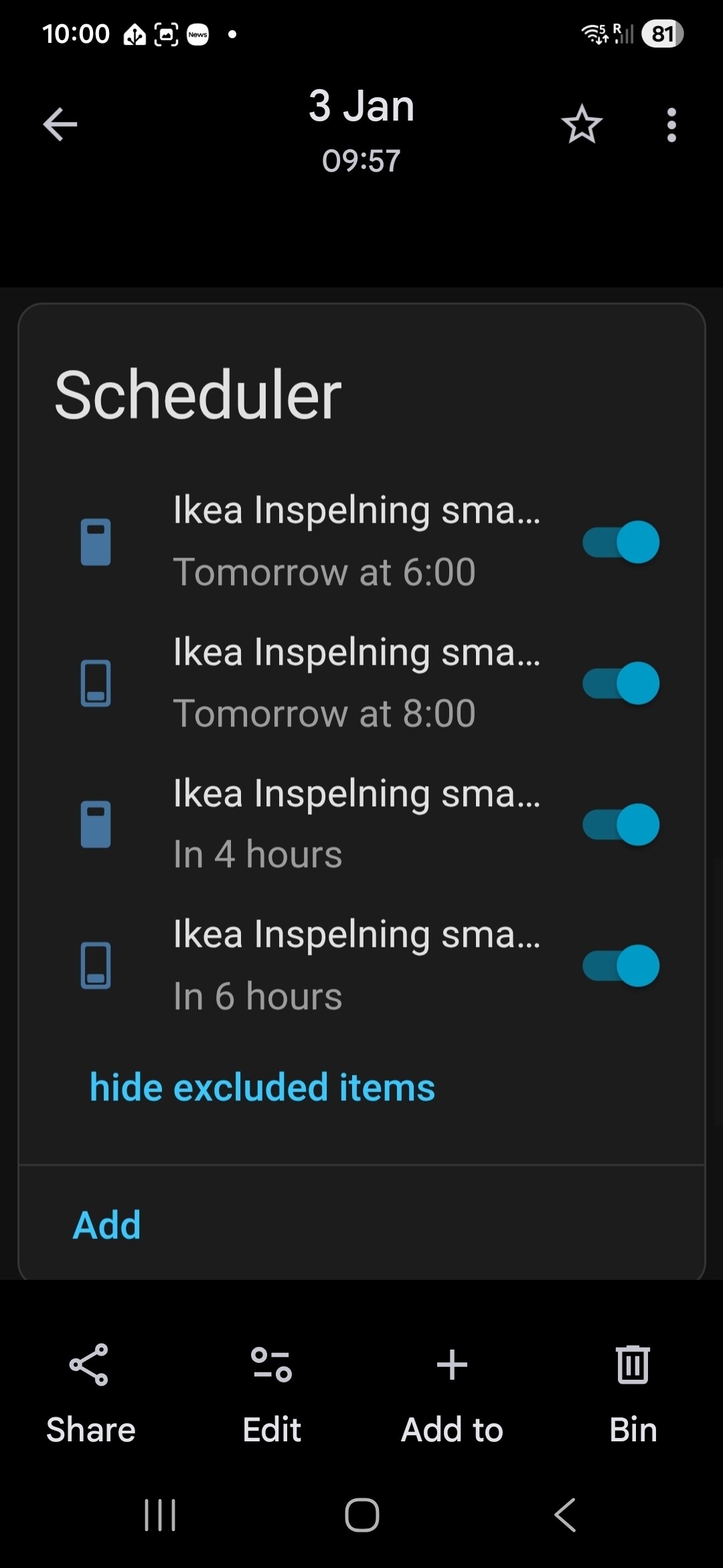

FWIW this is an outstanding module and should be a part of HA core, however I do agree its tough to get your head around.
For example, why do the below show as excluded. Though it seems to work fine.

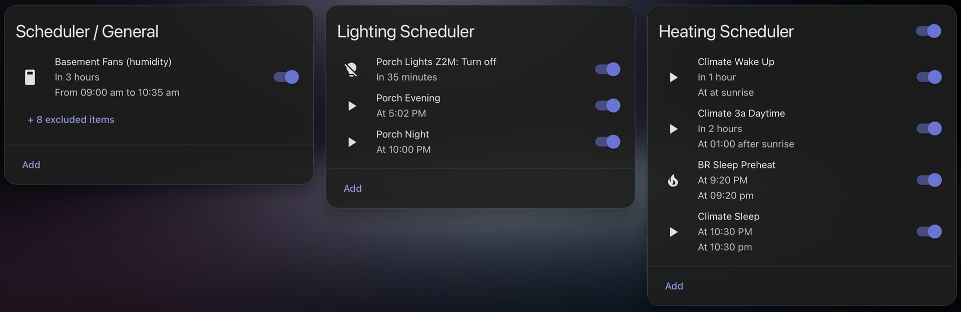

Check the TAG(s) assigned to the card, and then the TAG(s) assigned to the individual schedules.
Tags are filters, allowing one to have multiple schedule Cards that each show a different/filtered set of schedules.
Scheduler/General card ā€œfilteredā€
Scheduler/General card ā€œunfilteredā€
Thanks for that could’nt see anything obvious but recreated and resolved the problem. Appreciate help.
