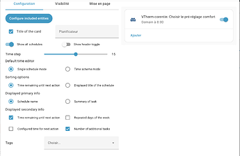

When I was using it, I had a friendly view, like the one it github Readme:
But now, view is less clear:

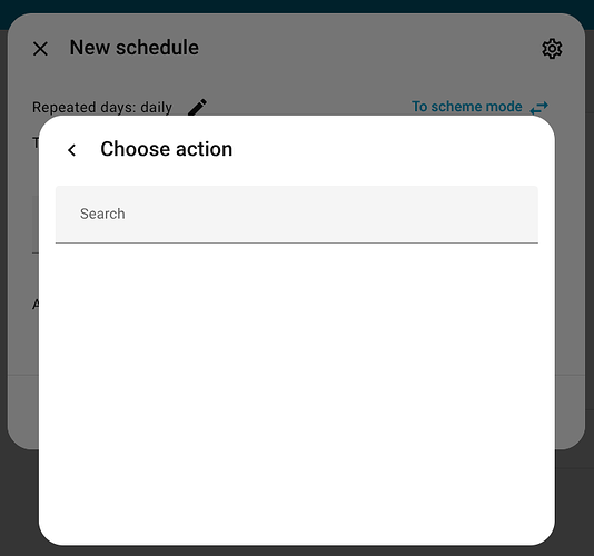

First screen when creating a new card is really unclear:
Am I missing something?

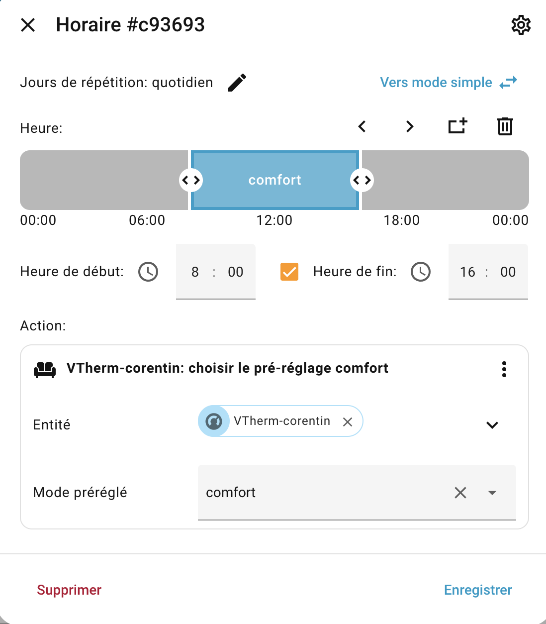

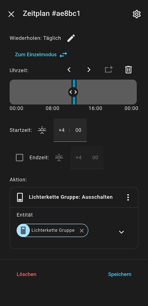

With the button to the right of “>”-symbol you can add another time slot in the same schedule.
That button is greyed out whenever there is sunset or sunrise in a Schedule…
But I would like to mix sun and fixed times, so that’s not possible like that…
Try clicking on the grey areas.

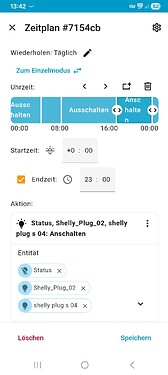

I had a schedule for a my Xmas-light going, which were turned on at 06:00 and off at sunrise. In the evening they got turned on at sundown and off at 23:00. Everything was in one schedule and worked fine.
I just tried it and found out that I could just click on the clock icon and turn it into a sunset/sunrise icon…
Thank you for your help!

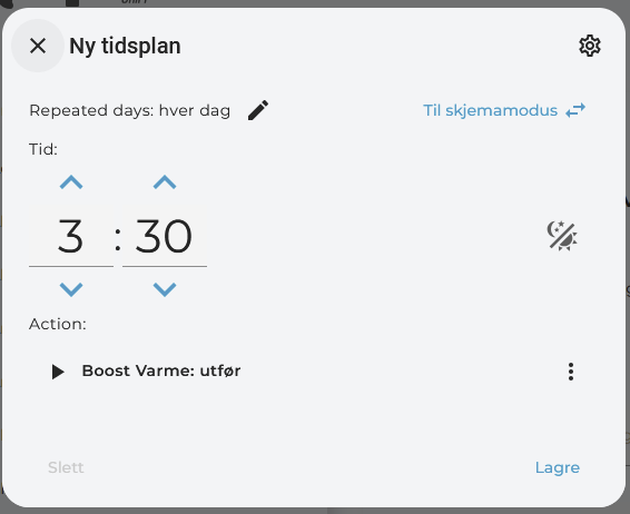

I have a script that takes a climate entity as a input and boosts the temperature before in falls back to the set temp from before the boost takes place, while this is OK to manually run and with buttons etc, it would be nice to set it to start on a schedule…
So: How do I give scripts arguments/data? i cannot see any logical way of doing this … I don’t want to create climate-specific boost-scripts as that creates clutter …

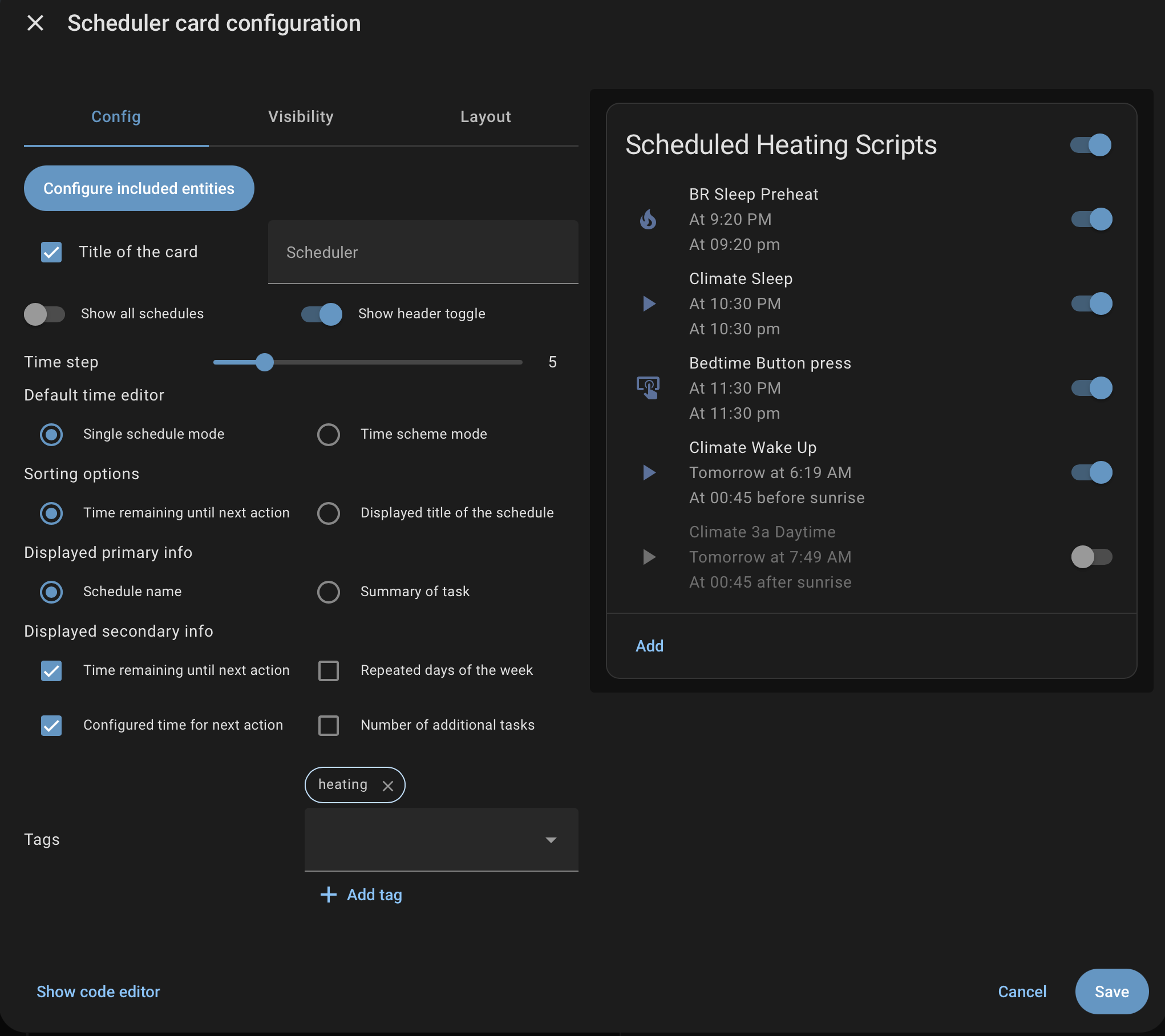

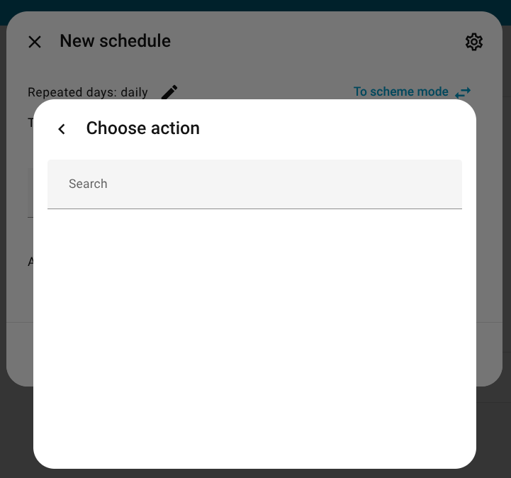

I’ve installed Scheduler and used it to set my blind tilts at sunset which works great - very happy.
However, when I try and schedule a switch, there are no switches found. I was expecting to see at least my plugs (about a dozen of them) here. Also Lights is equally blank and I’ve got at least 10 bulbs in HA. I just get the search box and no devices. What am I doing wrong?
Thepillock - before you try to add a new schedule to the Scheduler Card, edit the dashboard and then edit the Scheduler card. There you can “Configure included entities” to insure you can create schedules for the lights and switches you have in mind.
Oh! Amazing, yes that was it :slight_smile: I knew it would be a me problem!
(I’d not actually selected anything at all, they were all 0/12, 0/20 etc so it’s slightly weird I could see the blind tilt, but now I’ve selected blinds, lights and switches they’re the only three types in the list where before it showed all types, but barely any devices)
Thank you for the help.
