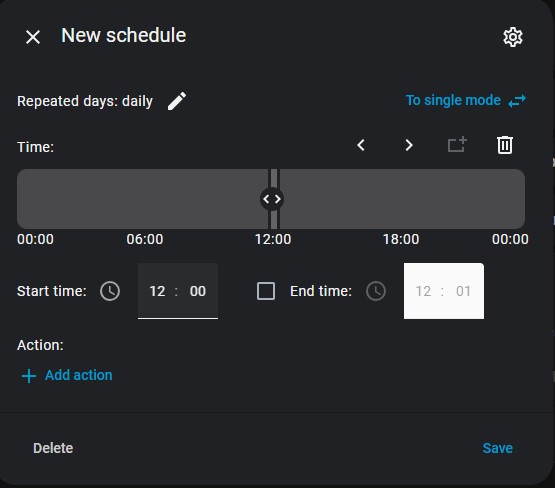

My scheduler card doesn’t appear as user friendly as shown in the following link
Specifically, the actions / entities are not selectable by icons, instead I have to click on “Add action” and search for the entity.

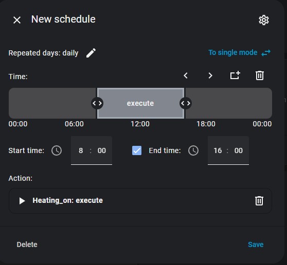

However when I add an action to my scheduler to run the script, there is no option to set the fields…
