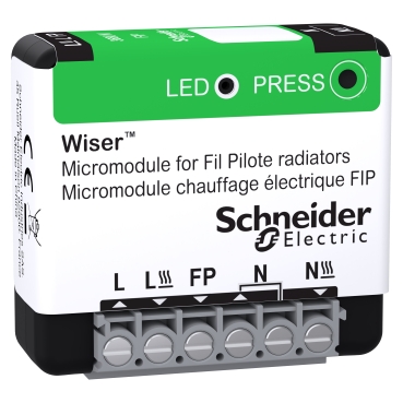

Schneider Electric CCTFR6710 ( heater module with fil pilote )
Hello !
This question is mostly for French people as I think the “fil pilote” is relatively unique to our market.
Is anyone using Schneider’s CCTFR6710 module in Home Assistant without a Wiser hub / and or without Wiser thermostats?
A friend of mine has 8 heaters he’d like to control but we’d love to skip the Wiser hub since this is a Zigbee device.
However, given the fact that this is quite specific in terms of settings, maybe it doesn’t work or won’t display all the properties we need to exploit the module.
For the curious ones, the “fil pilote” is a way to give instructions to a heater , it transmits orders on how to run.
Of course now modern radiators can have native Zigbee connectivity and better control but … when you have existing heaters it is an interesting solution.

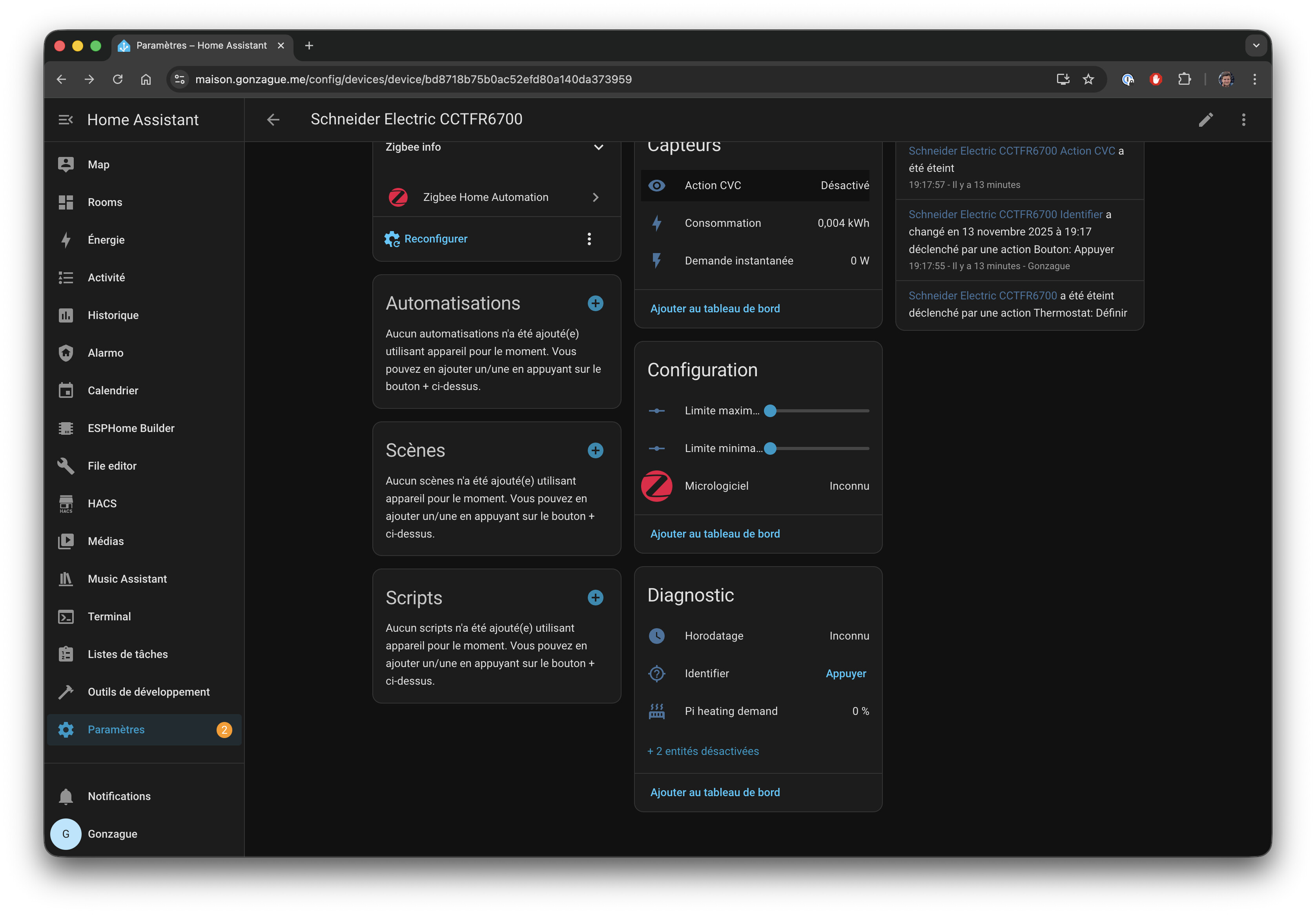

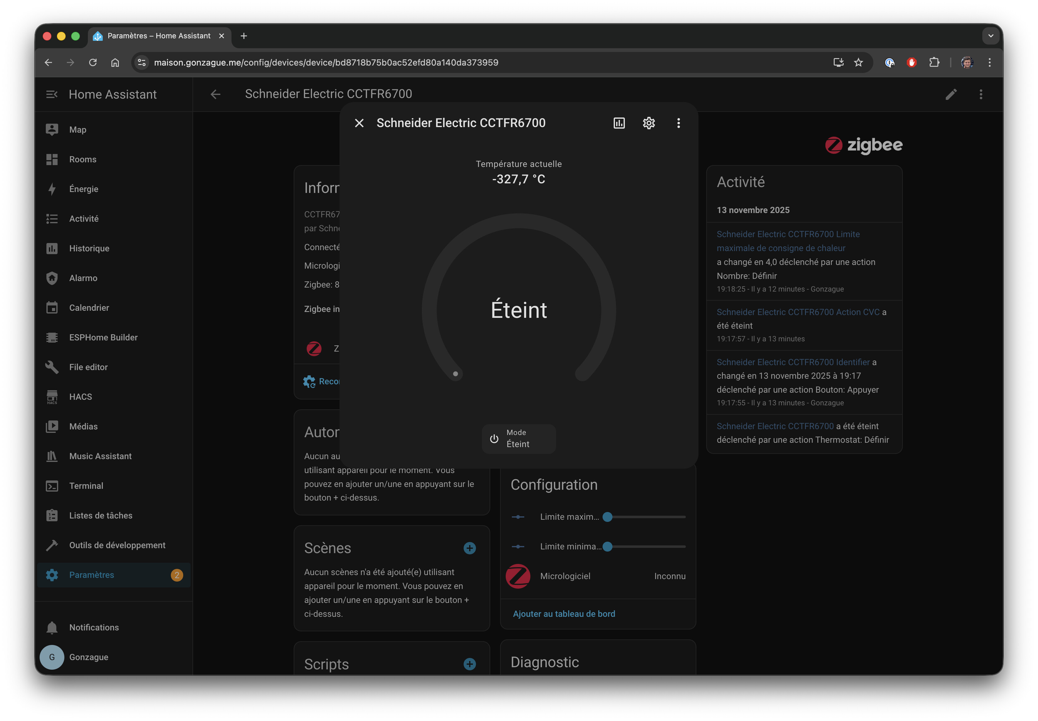

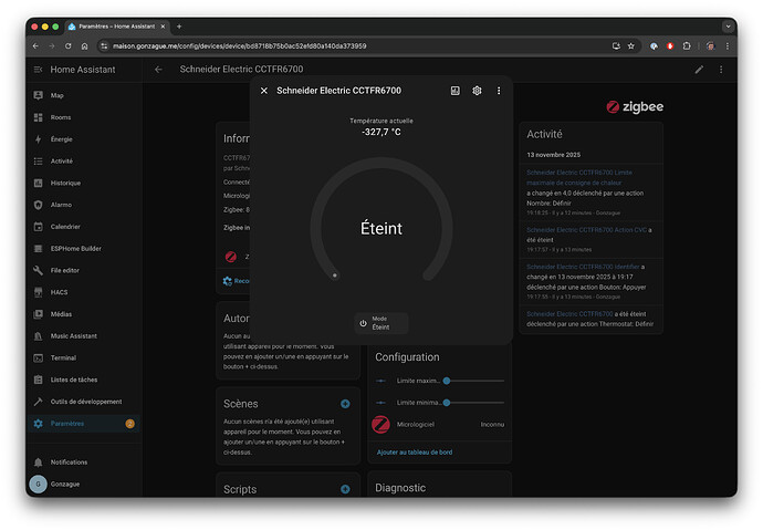

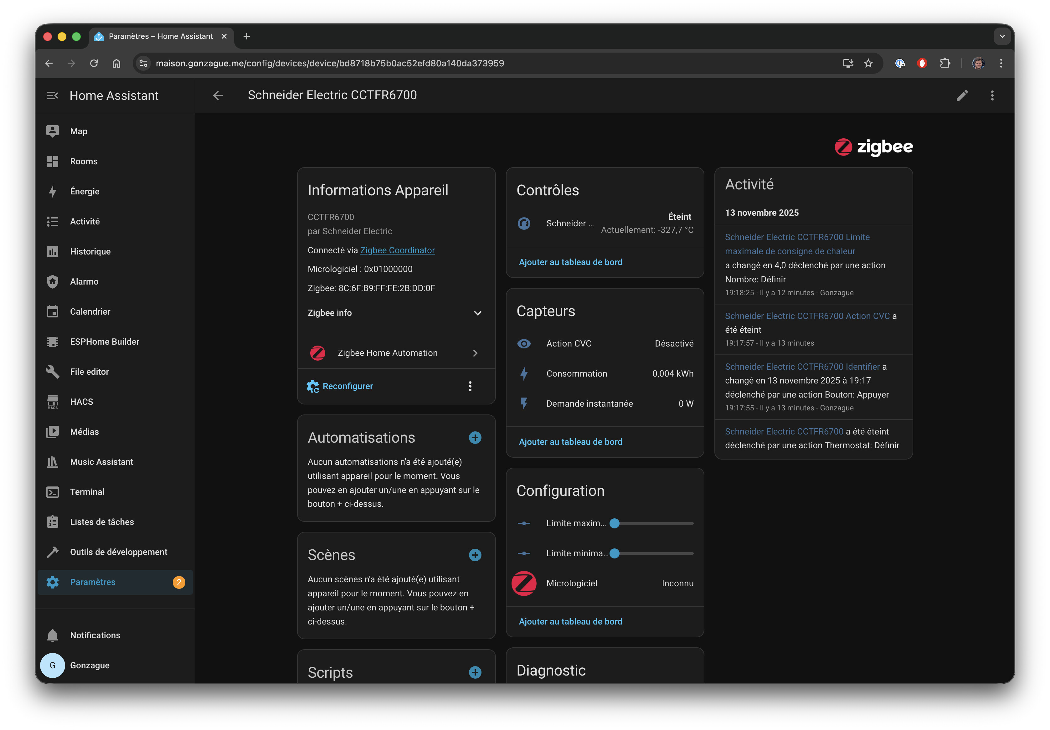

So I went ahead and bought the CCTFR6700 from Schneider (which is not a micro module but same features) , in the regular ZHA integration the amount of info and controls exposed is limited :slight_smile:
I dont use Z2MQTT , is it worth migrating to it? For the moment the ZHA way was “okay” :slight_smile:

Thanks Dan, I’ve installed Z2M and added the device, there are some missing / unexposed properties, i’ll check with the Z2M part :slight_smile:
Now i need to find how to send to the device the temperature from a thermostat :slight_smile: I’ll check the instructions from this post Schneider Electric CCTFR6700 16A Relay - external temperature sensor - #8 by ShellCode33
