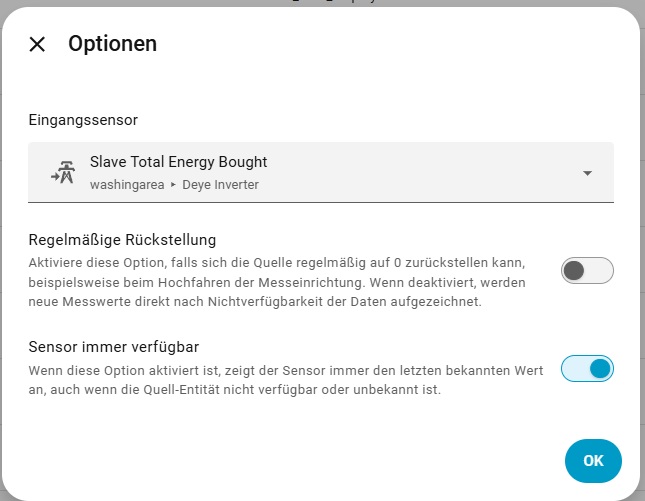

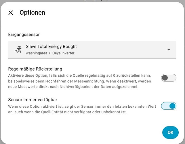

When I click on it, the configuration opens like this:
As far as I can see there are a lot of field missing to fix my problem!!? Isn’t it?

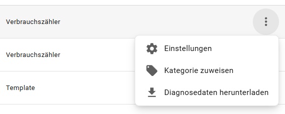

I cannot even delete it the way I would delete any other helper:
I have checked where these helpers are stored, but in the main-folder next to configuration.yaml, automations.yaml and more…I do not see any helpers.yaml. So this is the wrong way.
I would assume - from a perspective of a software developer, something is going really wrong while collecting the data to display the config (for repair). Well, that is fine for me.
But at least catching this error and allowing me to delete my “garbage” and start from scratch would be “nice”.
Does someone have an idea how to remove it?

Go to the integration page for utility_meter.
There should be a config_entry here for this sensor. You can delete it there.
