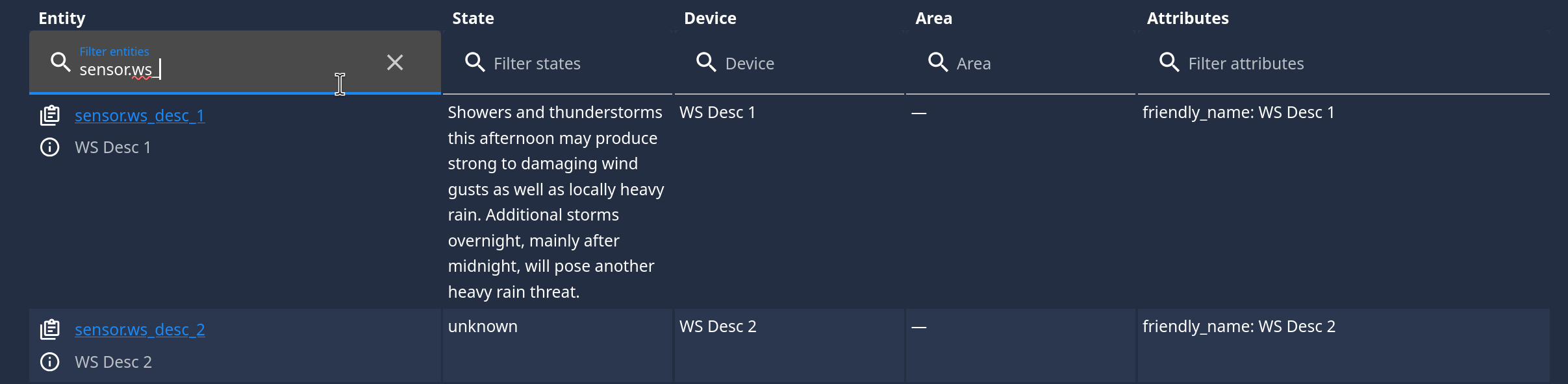

When I use the Scrape integration in HA, and use the same resource, same selector, and two sensors using index 0 and index 1, I get:
Index 0: “Showers and thunderstorms this afternoon may produce strong to damaging wind gusts as well as locally heavy rain. Additional storms overnight, mainly after midnight, will pose another heavy rain threat.” This is as expected.
Index 1: “unknown” Not as expected – see above for interactive results.
I have debug logging turned on for this integration but no messages appear in the log. What’s happening with index 1?
