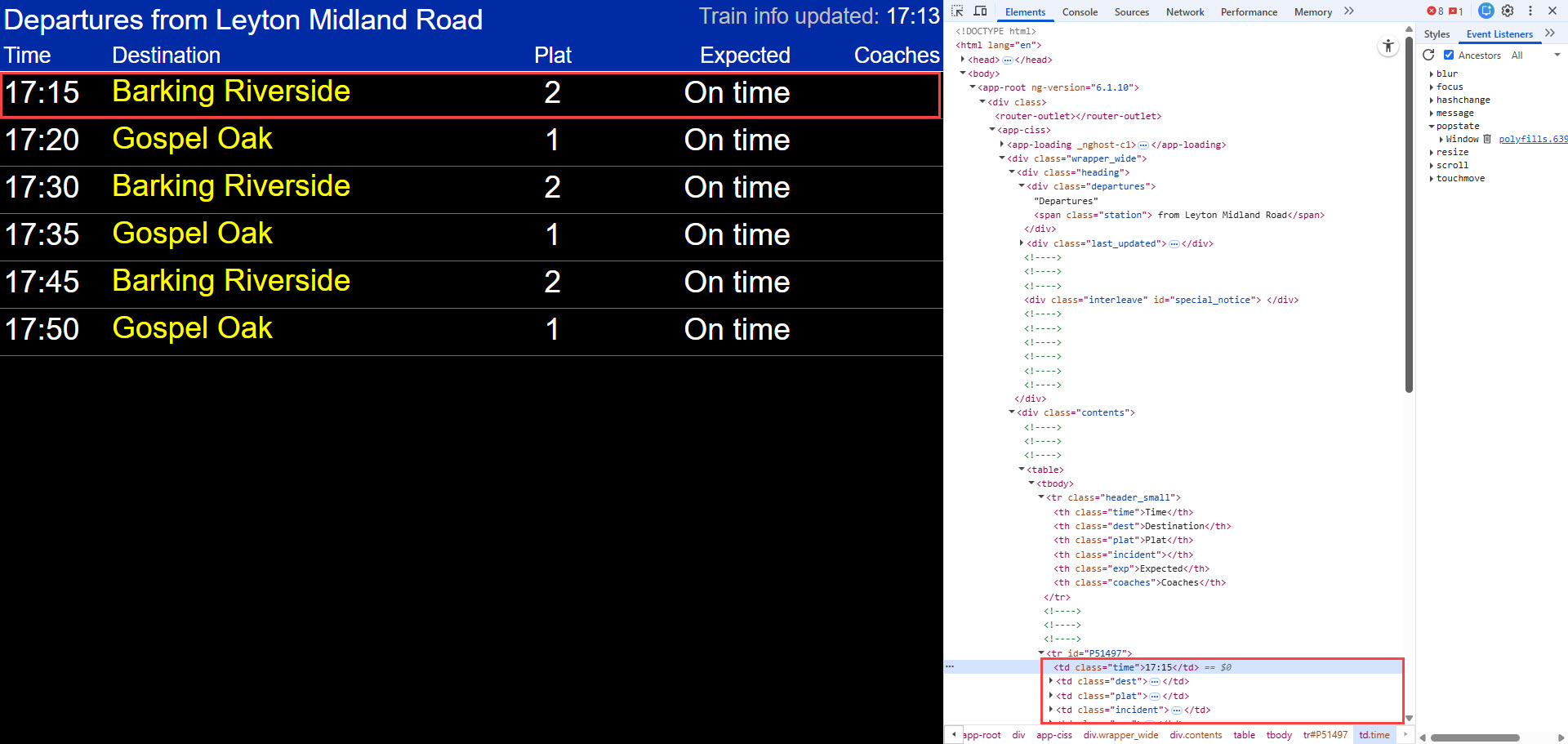

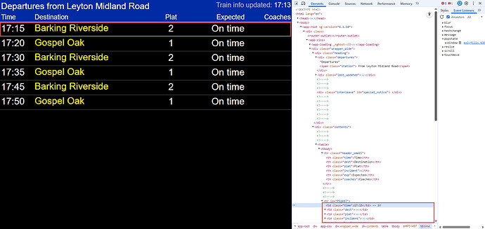

I would like to use Scrape for this website https://tiger.worldline.global/LEYTNMR/ciss where I just like to retrieve the first row of data/train information. The TR tag ID changes, of which I am simply trying to retrieve by “Nth” row instead. Using table > tbody > tr:nth-child(1) in Select of the UI
Spend over an hour trying to work this out, so feel slightly defeated. Any help will be much appreciated, thank you!
