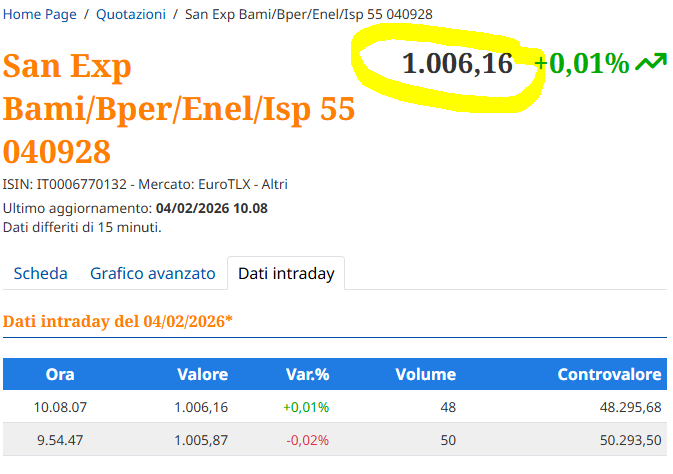

Sorry but I wouldlike to scrape a value from a website. I’m trying to do it with the scrape service included in HA but I’m finding some difficulties.
This is the source URL SOURCE and I would like to scrape the certificate value.

Not sure what the certificate value is exactly but if it is this one below
the in the select you only need: #ctl00_phContents_ctlHeader_lblPrice
