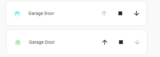

But how can i the change the arrow color
when screen is up the arrow to move up should be grey-out like this
3
and when screen is down the arrow to move down should be grey-out
can somebody help me in this case ?

Only thing is, it is purple when it is open (1)
and when it is closed it is standard color , blue
it should actually be the other way around
How can i get something like this
Do i have to overricht the default themes ?
Every attempt i have made, the icon disappeared
