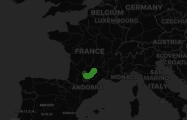

Yes! This is exactly what Scribe is perfect for.
Home Assistant’s standard Recorder purges device_tracker history after 10 days because keeping GPS coordinates every few seconds fills up the database very quickly.
Scribe solves this: It stores all state changes, including latitude/longitude attributes from your trackers.
It uses TimescaleDB compression, which is incredibly efficient for repetitive data like GPS coordinates. You can keep years of location history for negligible disk space.
Visualization: You can then use Grafana with the Geomap panel to visualize your own private “Google Maps Timeline”, entirely self-hosted and persisted forever.
Check what I do:
Give it a try! Just make sure to include your device_tracker entities in the Scribe configuration.
