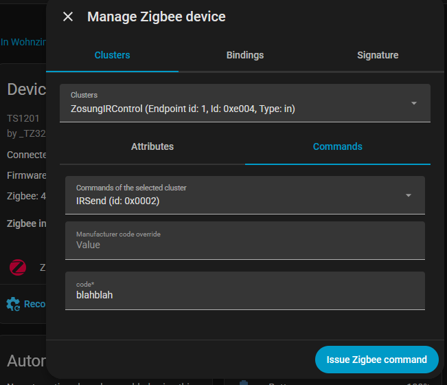

I have this UFO-R11 infrared blaster which works fine, when I send a code directly in devices → manage zigbee device
cluster: “ZosungIRControl (Endpoint id: 1, Id: 0xe004, Type: in)”
commands: “IRSend (id: 0x0002)”
→ can control my 2 remote controlled ceiling lights at once

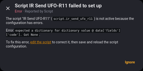

verify the action name in settings → developer tools → actions is correct. Select the script action, then swap to yaml mode to see the name of the action.
You should be seeing an error for that script since the code field is None…
At least give it a name… but since you haven’t provided a default in your template, you should really mark it as required as well.

Ok, I am using your version now and when toggling the light I get:
Failed to perform the action light/turn_on. expected dict for dictionary value @ data[‘params’]

I’m not 100% sure what the script needs to look like, this is how I send codes successfully:
