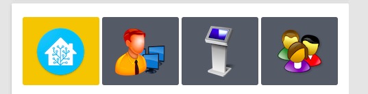

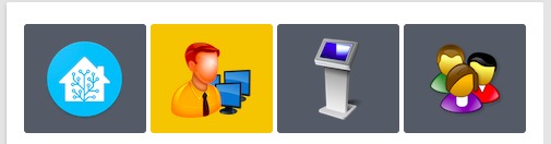

screenshot:
normal mode:
54
click dev mode:
16
09
revealing group.developer and some, click Catch! and show Ungrouped Items:
flip developer mode switch back off:
31
