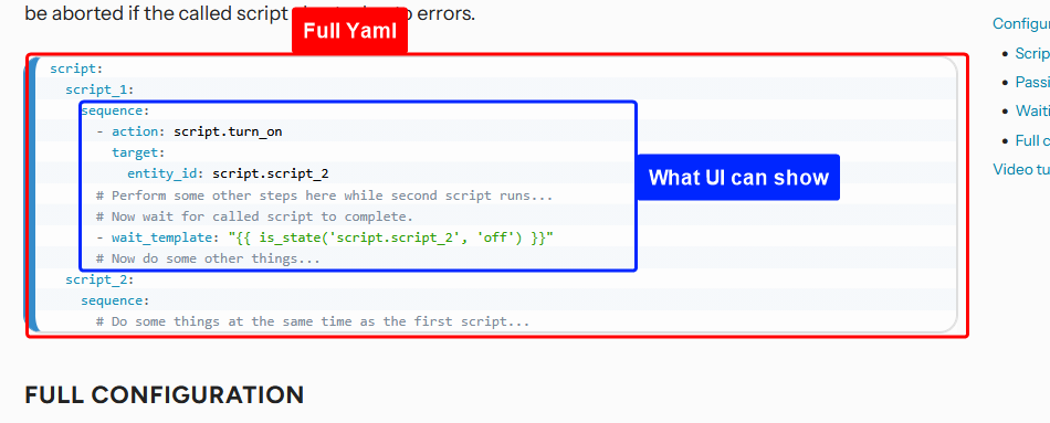

  4. The service name is derived from the slug in yaml. This screenshot shows you what the UI can provide access to in regards to the full script yaml
    The only way to edit the service name is to edit the slug, in the example above it’s script_1. It takes 5 seconds, literally 5 seconds to open your scripts.yaml file and change that name followed by a restart. Your service name (NOT ENTITY_ID) will properly update. This is all doable from within home assistant through the file editor app or the vscode app.
  5. Last but not least, changing this functionality to allow the user to adjust the slug from the UI would be a breaking change. We would need to make the script section a list, not a dictionary. And the slug would need to be an additional property like it is for automation. It’s unfortunate that this is something that is holding scripts back, but you need to understand that the integration is literally the oldest integration in HA and any changes will cause massive problems for all users. Meaning, changes should be avoided unless it’s absolutely necessary. And sorry, but this is not an “absolutely necessary” situation.

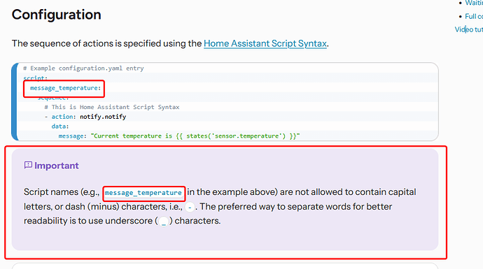

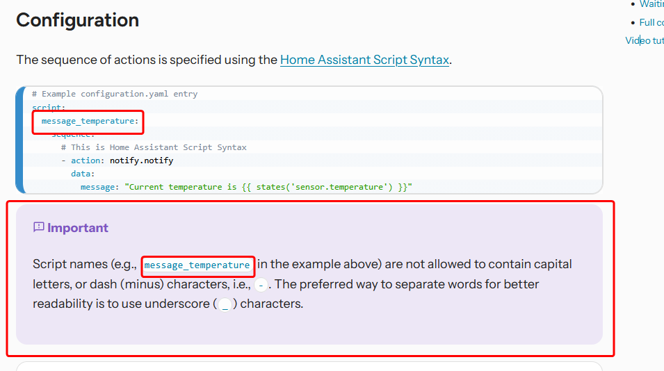

Yes it is, I already linked it above and took a screen shot of it. It also has a nice big ole important tag.
There’s even mention in the documentation lower that covers calling the script directly using script.NAME or using script.turn_on.
