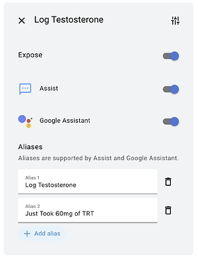

I exposed a script in Home Assistant to Google Home through Nabu Casa. The script does not appear in the Google Home app anywhere.
Current Setup
I have 20+ devices connected through Nabu Casa (lights, switches, etc.). These devices work correctly and have for years. This is my first script exposure attempt.
What I Did
  1. Exposed the script in Home Assistant settings
  2. Added aliases to the script
  3. Assigned the script to a room that exists in Google Home
  4. Tried setting a Google Home Automation with the Script as an Action - it does not appear as an option

They should appear, in one place only. In automations of Google, when you pick a smart home action, they are there. You can for instance create a custom starter sentence and pick the script as the action. You can also activate them by saying: start < script name >
I would post screen shots, but I recently switched to Matter hub to expose entities locally. If I recall right they are at the bottom of the list in automation actions of the smart home.
When you add new things you do need to resync though, just as with normal applyances.
They used to show up as a scene in google home. Check there.
