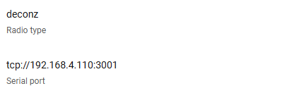

I use ZHA for my Zigbee software and it will accept the ser2net TCP connection directly:
Z-wave JS UI will do the same.

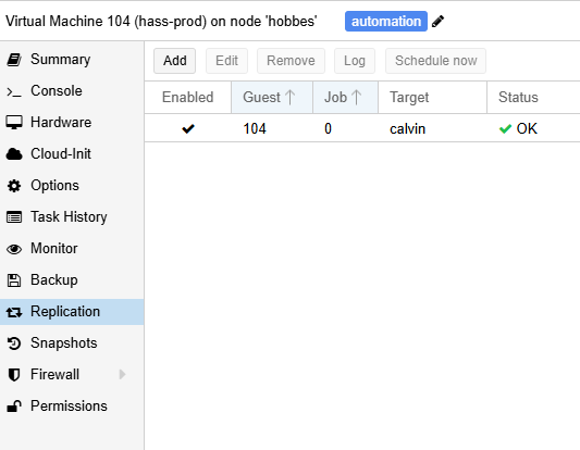

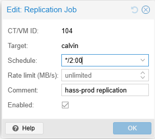

Make sure the VM has replication enabled:
Datacenter > Server > VM > Replication:

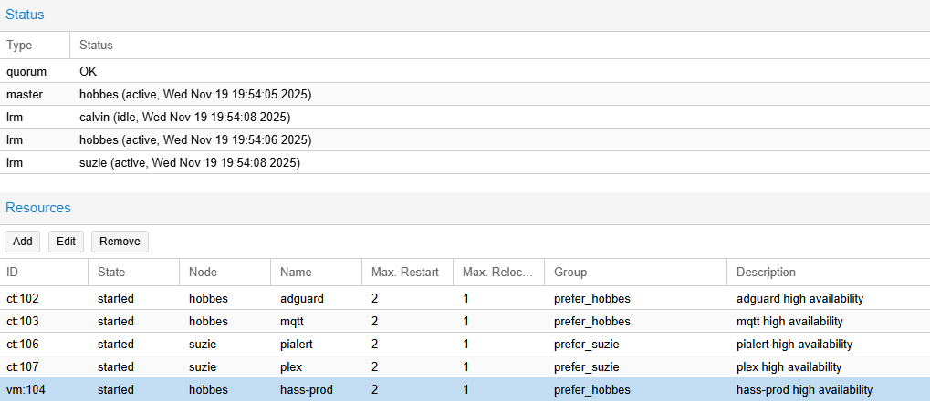

Configure High Availability for the VM:
Datacenter > HA:
At that point you can manually migrate on the fly or if the server fails the VM will migrate automatically:
I’m using a 2.5Gb dedicated migration network and things work pretty smoothly. VM replication takes about 10 seconds for Home Assistant.

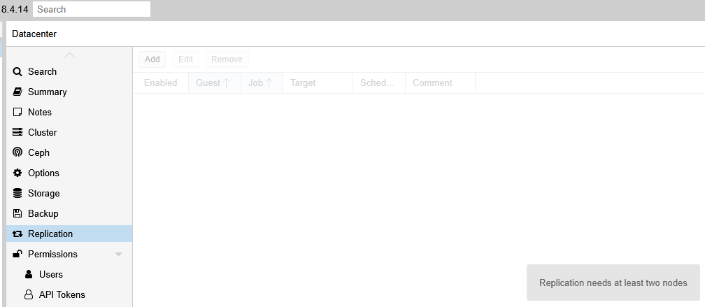

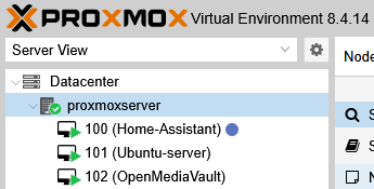

I do not have the clusters only 1 node called proxmoxserver
I run ZHA as the Zigbee software that runs in Home Assistant core.
One Proxmox node equals no high availability. You’d have to have more Proxmox nodes to support a cluster and then High Availability.
