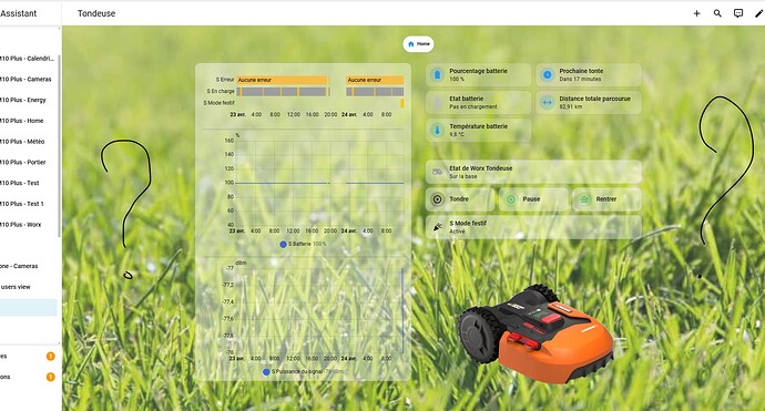

Hi there,
Using a standard “Sections” type dashboard for my mower, I see 2 columns but they do not take the full width as you can see (I’d like to use the space on the left of the History cards to have them widder).
any clue how to solve this ?
Why a 2 columns is not taking full width ?
Here is a picture and my code :

Many Thanks !!
Columns have a max width of 500px. Can be set in theme by var ha-view-sections-column-max-width
I think you can’t do this with sections. All cards in this view have maximum width set by developers and can only be made narrower. If you want to have some more granular control over cards width, go for grid view or panel view with layout card to define uneven split of width between columns.
