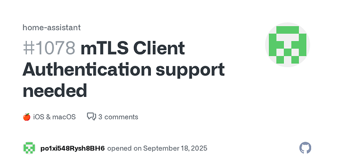

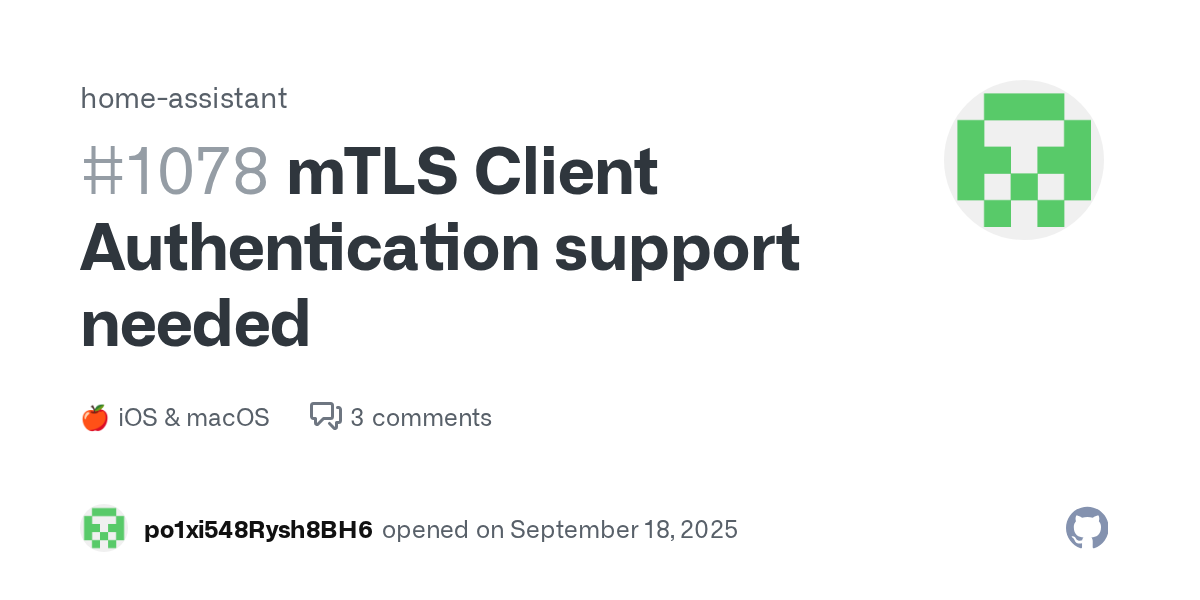

I would see that we can Cloudflare Headers in the App. So we can use the CloudFlare Zero Trust Application with Service Tokens Allow Access.
Someone did a feature request but it get rejected. I can’t understand why… it’s a good way of protection and you can turn the feature on if you wanna use it.

I asked to make it possible to add headers in iOS app. I’m using Cloudflare zero trust and applications with policies. Wanna add f service token in the app so I can create a policy to allow connection to HA otherwise deny it.
Hopefully the recent PR by marius or the previous one by sevi might get a chance. Its not understandable why HA would not support the implementation of custom headers and/or mTLS.
People want to implement authentication and remote access on their own. Its not about, hey, you might subscribe the Nabu Casa service, its about the open platform itself.
