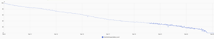

Last battery update. 30 min refreshes last around 16 days.
