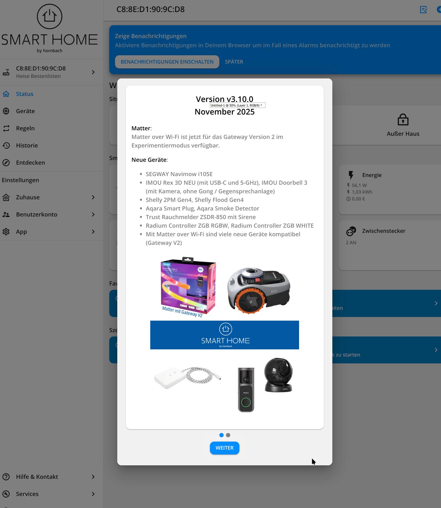

Hi all,
do we may have an option by using the “HORNBACH” smart home solution?
This seems to be a Cloud Sevice by german hardware store Hornbach, which is officially supported by navimow:

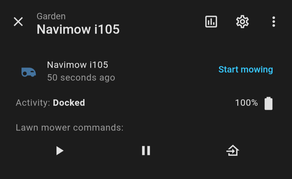

There seems to be an integration in development: GitHub - segwaynavimow/NavimowHA · GitHub
I did not check it out yet as it seems your Navimow needs to be online to configure it.
How do we know this is a legit Segway Navimow repository?
Seems to be working!
A colleague of mine is in a developer and beta tester group. He said that Navimow is now actively working on creating the long-awaited API. It’s not perfect, but it’s on the right track! We’ll see :wink:
It works for me too :+1:
Wow - nice find! Thanks much, @TriggerHappy
Over the past weeks I have been trying to integrate my brand new i206 into HASS and have gotten myself into one rabbit hole to another rabbit hole…
Now thanks to this github code I have gotten to the point where the card shows just like’s @KOzalp screenshot.
Next step is to test it. Thus far my mower seems to be connected to HASS, but is not responding to my HASS commands. I am suspecting this is because I have not set up a map yet. Battery shows 100%, so I moved it off the charging station to see if HASS can detect a battery depletion.
Would anyone have any other suggestions on how best to proceed testing the HASS integration at this point?
