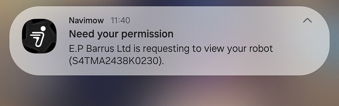

Since signing up to this yesterday afternoon I now have this notification…

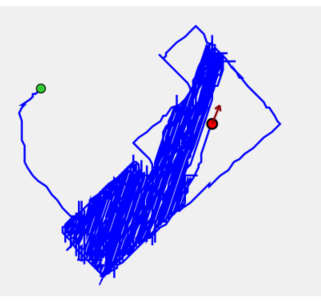

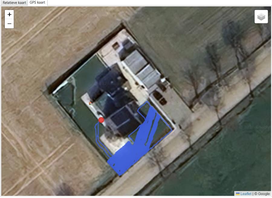

I have good hopes that we soon have a feature-complete working Navimow mower in Home Assistant. When looking at the Mqtt structure I guessed the /realtimeDate/location topic in Mqtt and suddenly I got location updates when mowing which I was able to plot on a little map in a xaml app with help of copilot…
edit: plotting on a google maps map is also quite easy

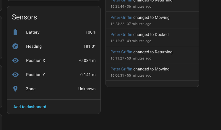

Is the status updating for charging and mowing for you as well?
Hello @CrownSeven
Postions are working for me, but zone not. Any idea?
Hello, same here for the moment.
