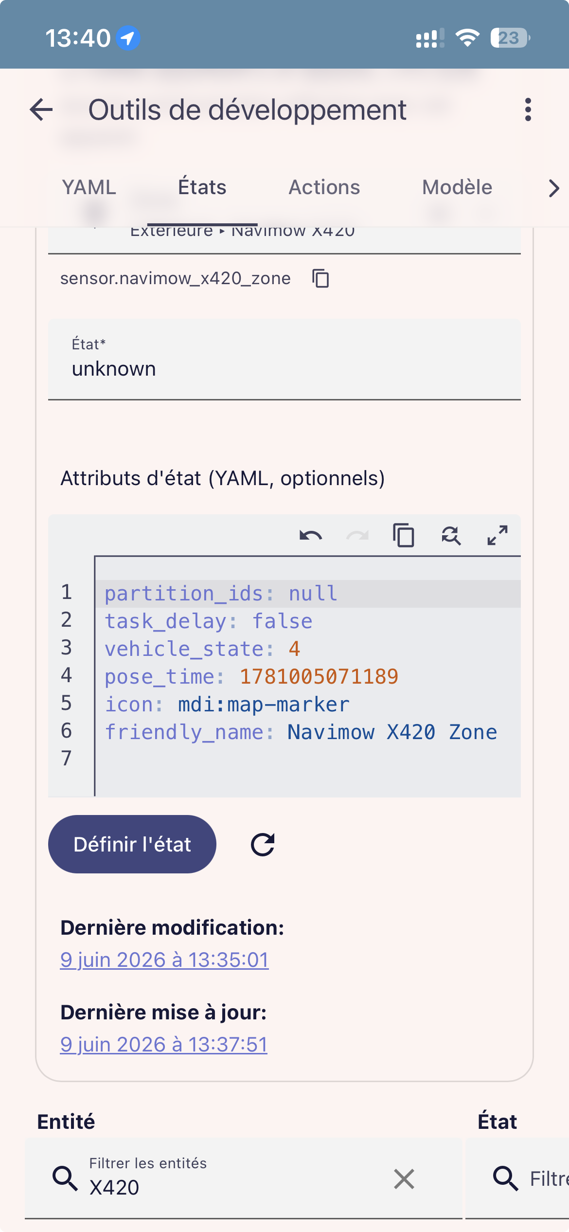

Édit : well it’s not reporting the zone when it is in auto lawing… I don’t understand how I can automate my Gate to open when it’s near. I have the Same need as you
Ok so when its triggered to mow by schedule is that when its not reporting the zone? If so I will look into that and see whats different with that flow.
Yes that’s it :wink:
You are correct. Let me do some more testing and I'll get back to you on if a 'mow all' can be better handled.
I think I found a way to identify which zone its in when issuing a 'mow all' command. WIll need more testing but should know in the next few days.

But ! My x420 was already in auto mowing all but paused due to low battery. Maybe I was in a particular state. I will see tomorrow and let you know.

What I found is a new type 2 message that shows action, currentMowBoundary, and currentMowProgress. It looks like currentMowBoundary is another spot thats reporting the current zone being mowed - even when issuing a 'mow all' command. The updated release now recognizes the type 2 messages and makes the property available for display.
So we basically have a target zone, and a 'live' zone. Which is useful, but not sure its a reliable way to identify which zone its going to for deciding if the gate needs to be opened or not during a 'mow all' command.
So for now, the updated release will default to opening the gate if the zone is unknown (like during a 'mow all'), until I can figure out a better way of reliably knowing where its heading to during a 'mow all' function.

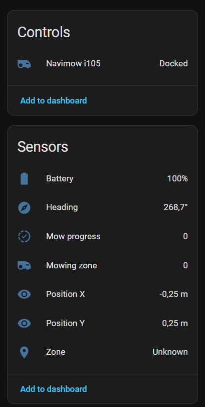

The map however gives a wrong position while docked:
Did you by any chance move the base station after the first setup? I set up up mine at my father in laws house first and now the values show a few hundred meters off all the time. I'll try resetting the position via the app tomorrow and report back.
No never, installed only once and correct...
