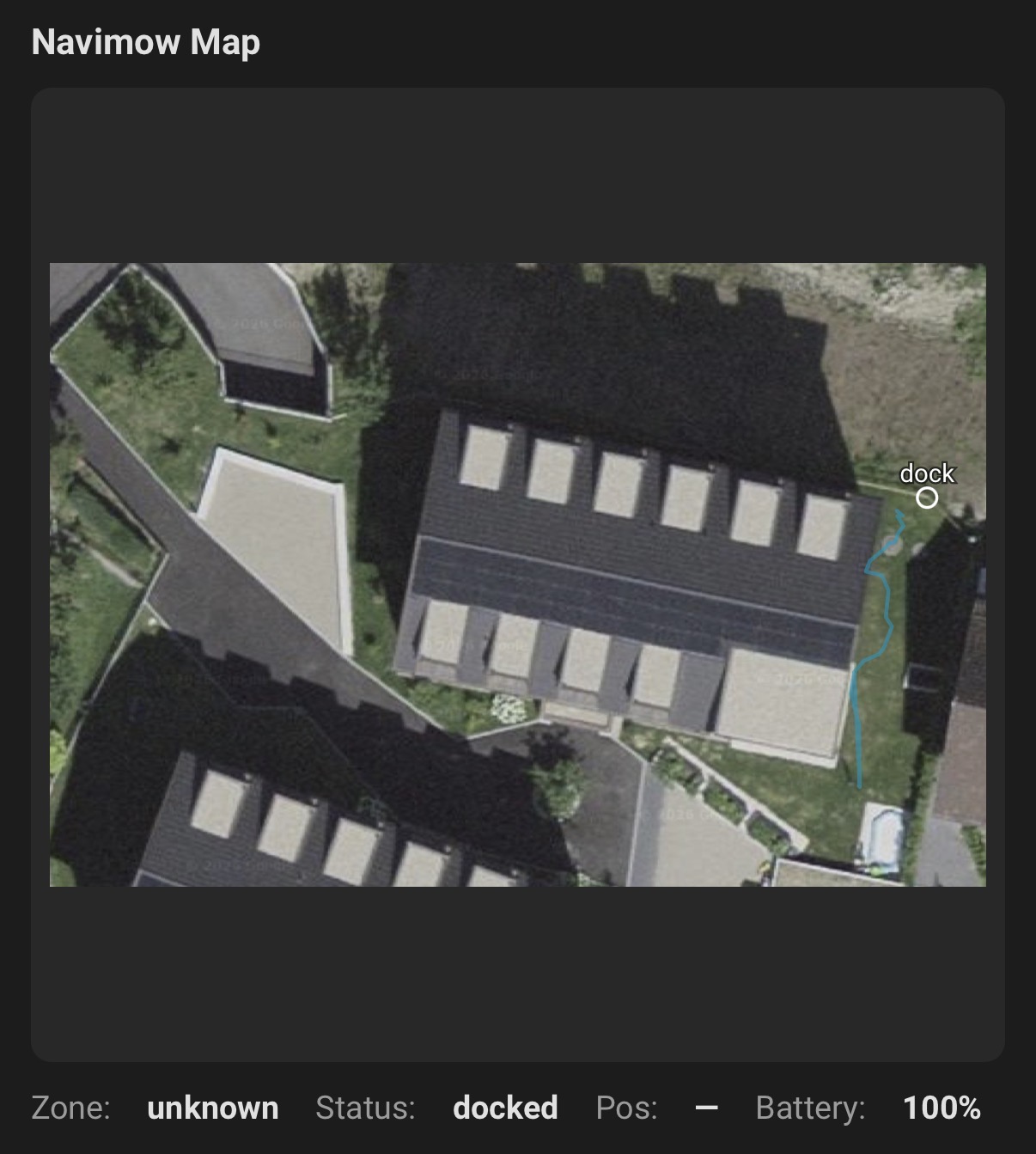

EDIT: Made another update that allows you to add a satellite overlay. Still needs more work to better translate the coordinates the navimow is reporting into a position on the image, but its not bad. Instructions are in the repo under examples - let me know how it works out!

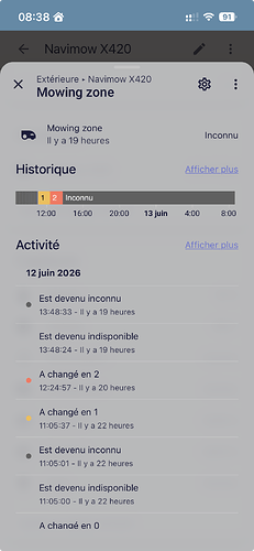

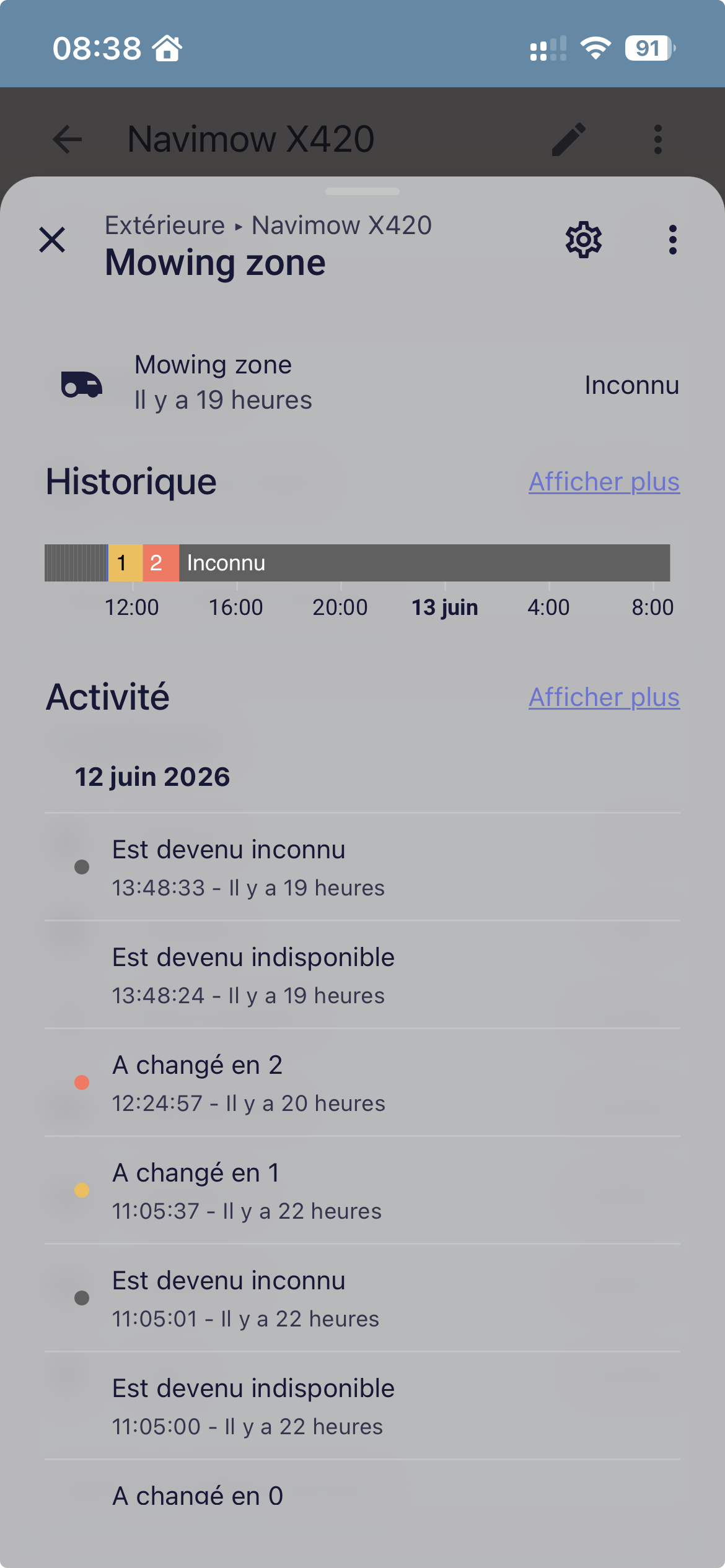

Did the 1.1.0+position.3 update and mowing zone is working great ! But « zone » is always unknown.

Which zone is not showing up for you? There are 2:
  • Mower Target Zone
  • Mowing Zone
The first is only reliably populated right now if you do single zone mowing.
The second seems to be set once its traveled to the target zone and is about to begin mowing.
What I'm struggling with right now is reliably identifying what the 'target' zone is when more than one zone is picked in a single mowing command.
It looks like the MQTT messages do include this info, but they do not keep the sequence as defined by the user, in the messages. Its passing an array of zones, in sorted order, and its not the custom order as defined by the user.
Hi there !
It’s the mowing target zone that is working. The other one doesn’t.
I only do « mow all » every day via scheduler
That would explain it. Its the issue I'm trying to solve. Identify a single target zone when specifying more than one (like during a mow all).

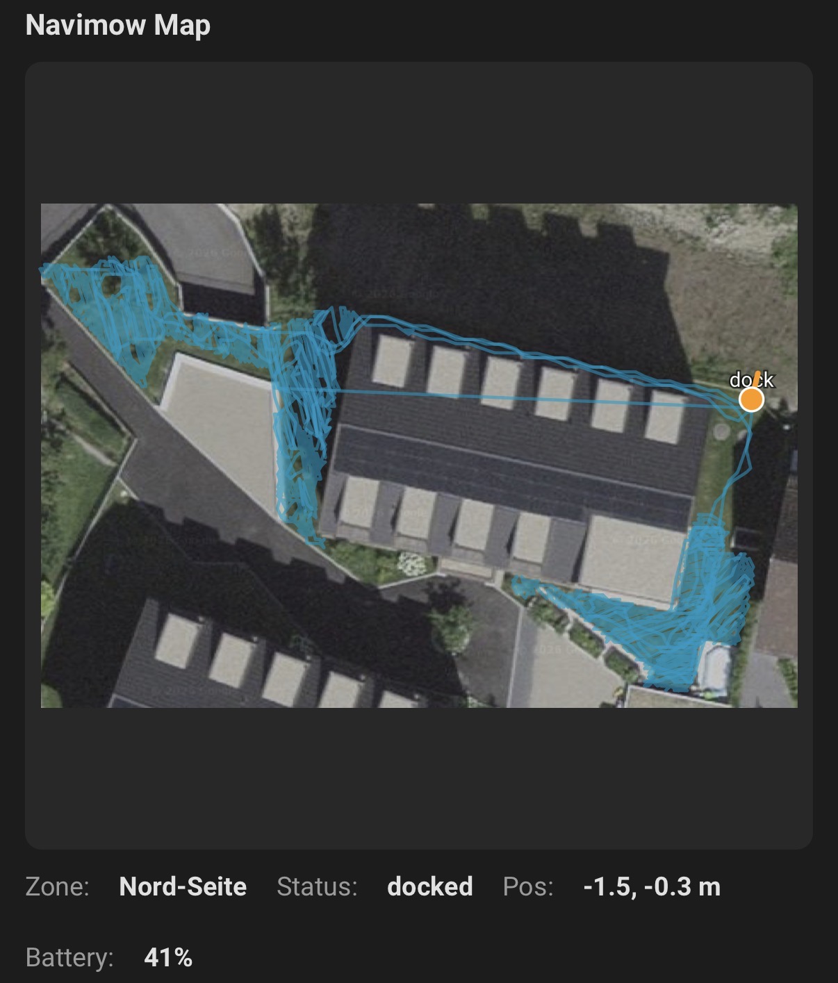

OK. I did update the map card slightly to allow for smoother mower movement.
