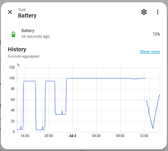

Thank you for @CrownSeven for maintaining this fork. Even at this early stage, it already performs better than the original branch.

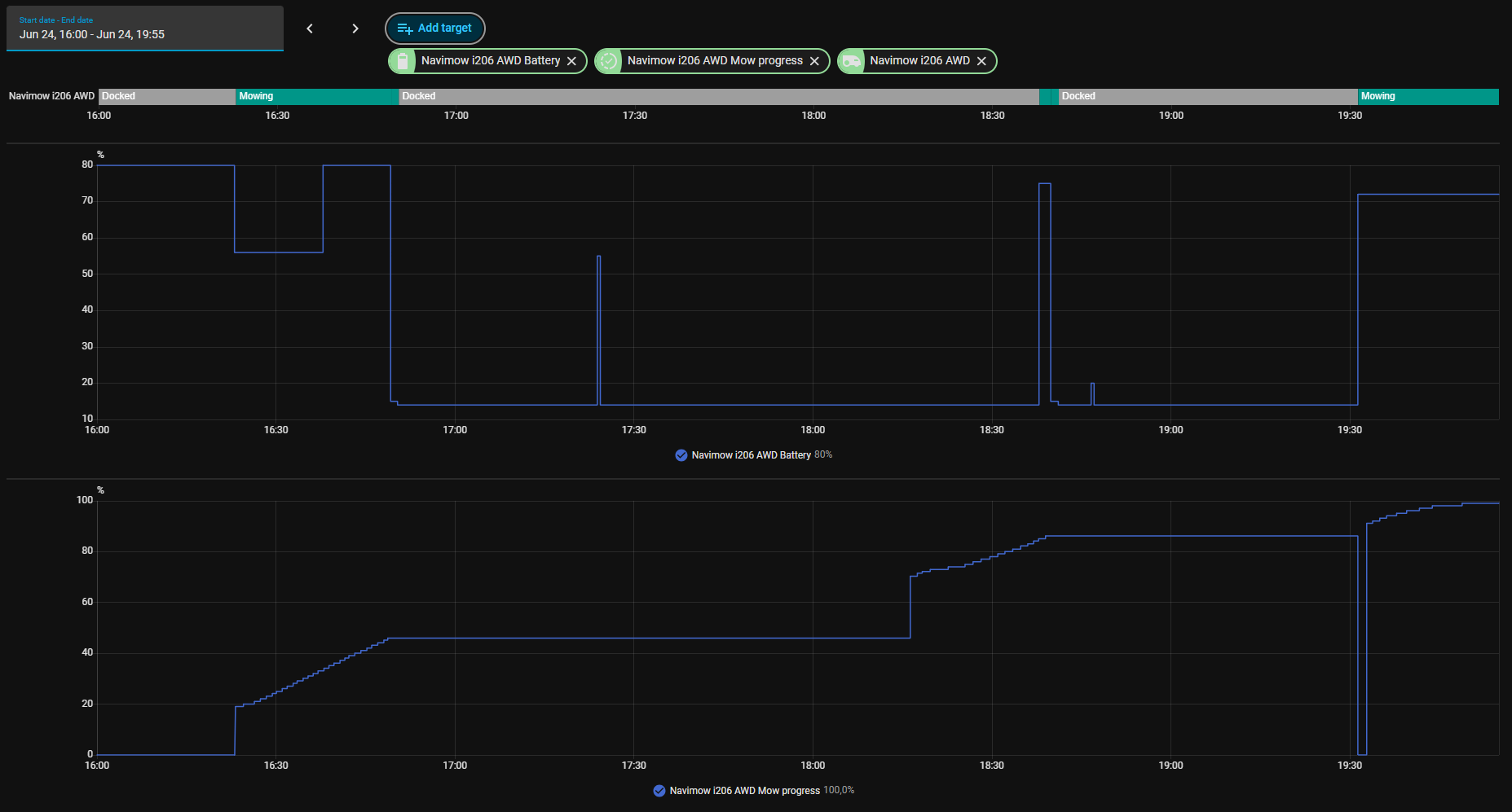

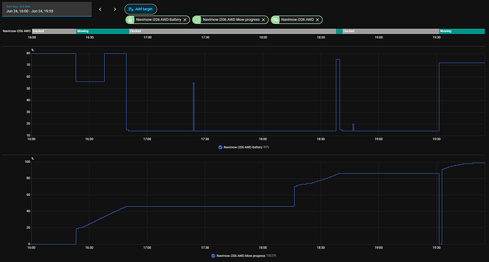

I would like to report issues related to mower state synchronization:
Battery entity:
The reported battery level appears to be out of sync. It frequently jumps between values, for example from 80% to 56% or from 15% directly to 55% (see attached graph).
Mowing progress and other entities:
State reporting seems correct from the start of mowing, but only until the mower goes to recharge. After recharging to 80% → mowing resumes; however, the mower state remains "docked" and other related entities are not updated. These entities begin reporting correctly again approximately 30 minutes after mowing resumes. The same issue repeats after each recharge cycle (see attached graph).
Based on this behavior, it seems that when the mower resumes mowing after recharging, the integration does not detect this transition. As a result, Home Assistant continues to treat the mower as docked instead of actively mowing.

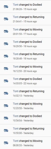

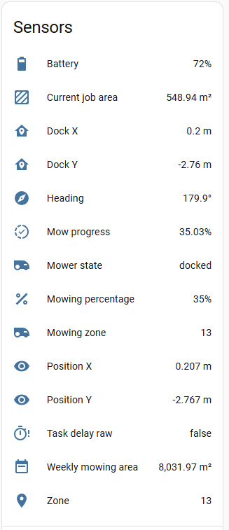

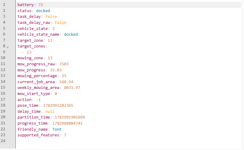

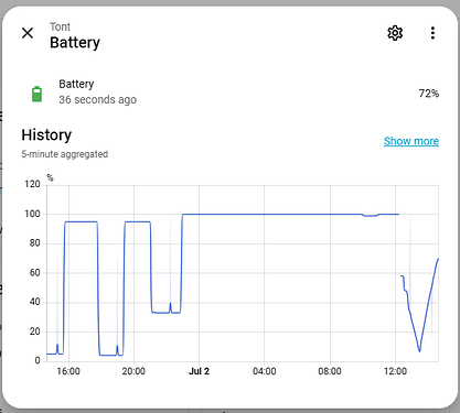

I tinkered a bit with @CrownSeven's fork and have reached the point where HA displays the following sensors:
The battery status was also updating very infrequently, so I set it to refresh every 2 minutes. Shortly after 12 o'clock, I uploaded the new code.
I modified the map card slightly to display the paths from the previous five runs in gray and the active mowing path in blue. Previously, it used to erase the old track after every charging cycle.
State attributes looks like this at the moment.
It is displaying the two zone sensors correctly so I can use them to set up gate-opening automation.
I have the H215 and X390, and everything seems to be working fine on them at the moment.
I haven't figured out how to send commands from HA to the mower to mow a specific zone, or how to toggle perimeter mowing on and off. How do you do that?
I also haven't figured out what "mowStartType" is.
P.S. I am by no means a software developer or coder; this is simply the work of AI. If you have any questions, I can send the contents of my .py files as a .txt file if that would be helpful. @CrownSeven did the heavy lifting to get us to where we are today. Thanks!

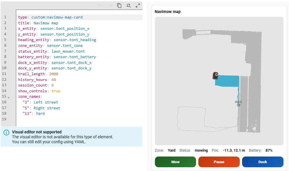

To answer my own question: I accidentially omitted the status_entity: config of the the map card. Once added, everything is fine.
I’ve made some more progress with the Navimow map card and decided to start moving it into a separate repository.
Until now, the map card has been included inside my NavimowHA fork, but updating it that way is not very convenient. A separate repository should make updates easier, especially through HACS, and it also makes the map card easier to maintain as its own project.
The first pre-release is now available here:
My NavimowHA fork is still here:
The map card has grown quite a bit from the first version. Current features include:
  • Visual editor support
  • Live mower position on a map
  • Live heading / mower rotation
  • Dock position
  • Historical trail rendering
  • Multi-day history view
  • Mowing session legend
  • Session filtering
  • Interactive two-point map calibration
  • Background image / aerial map support
  • Channel area visualization
  • Pinch-to-zoom on mobile
  • Mouse wheel zoom and panning on desktop
  • Configurable trail colors, width, opacity and fade
  • Configurable robot scaling
  • Custom robot SVG model support
  • Default robot icon loaded from dist/icons/h2.svg
  • Optional custom robot icon or MDI icon support
  • Customizable dock icon using MDI icons
  • Configurable dock scaling
  • Zone names
  • Automatic entity detection from the mower entity
  • Legacy overlay_image support, with the new preferred option being background_image
One of the main reasons I added the channel visualization was gate control. In my setup, I had trouble getting zones to work reliably enough for controlling a gate. Instead, I now use a configurable “channel” area based on the mower’s live position. When the mower enters that channel, Home Assistant can use it in automations, for example to open the gate.
The map card can now show these channel areas directly on the map, so it is much easier to see and verify where the automation trigger area actually is.
The project is still evolving, but separating the card into its own repository should make it easier to install, update and improve.

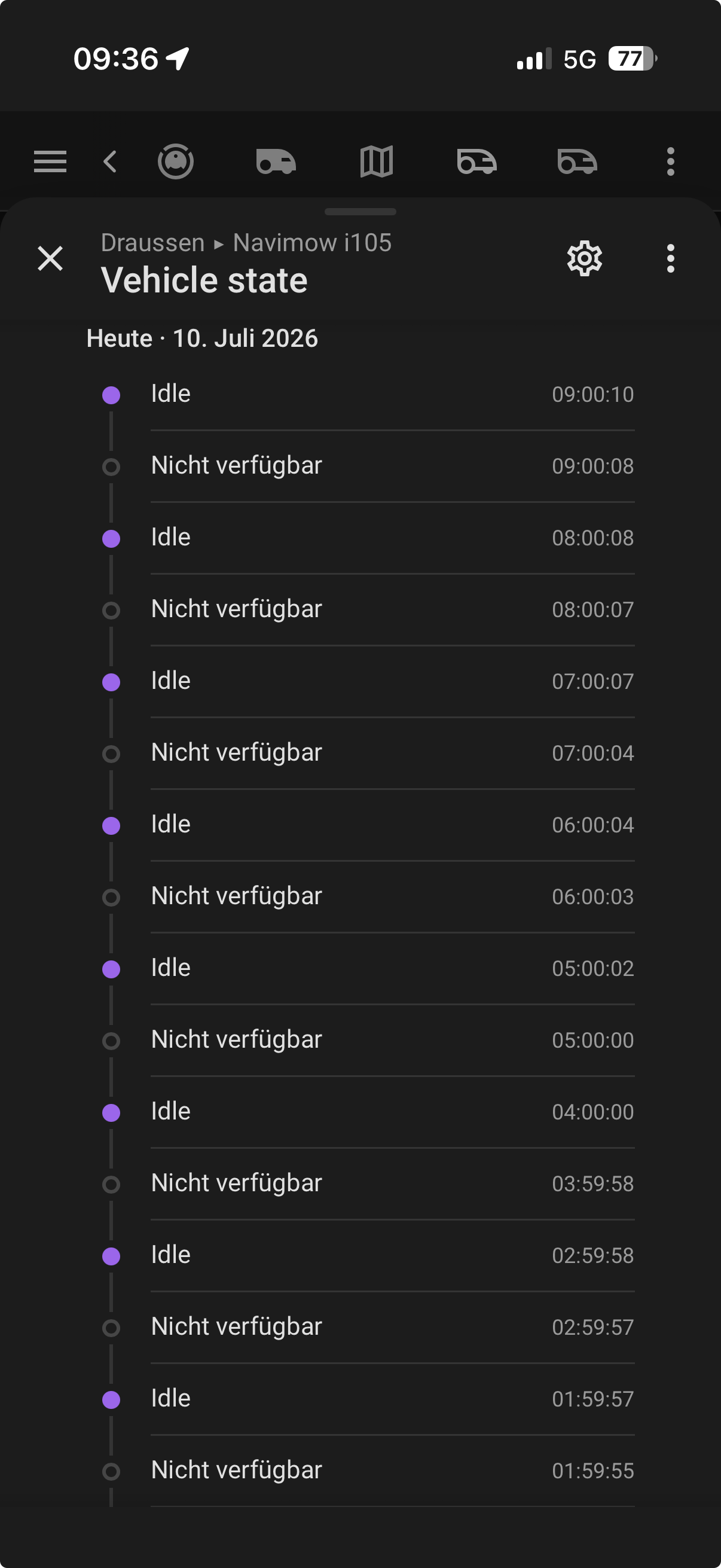

Hey @toomasv
Really great work, I like it!

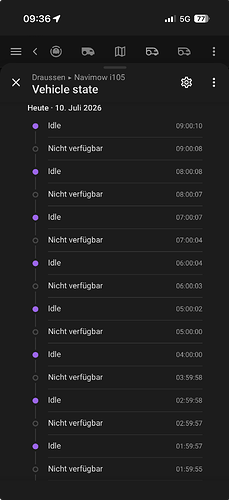

Short question: I have exactly every hour an interruption. Any idea or already saw this behavior?

Maybe a stupid question regarding vehicle state: when robot docks, state changes to „docked“. After „a while“ it changes to „idle“. Why and when changes it to idle? For what do you need this state?

New zone sensors include:
  • Zone X last area
  • Zone X last completed
  • Zone X last mowed
  • Zone X progress
  • Zone X session count
The integration now also tries to keep entity states stable during the hourly OAuth token refresh. Previously, entities could briefly become unavailable after every token refresh even though the mower itself was still online. The integration now filters these temporary refresh-related state changes where possible, so the logs stay cleaner and the last valid state is preserved. Live position entities such as heading, X and Y are excluded from this protection, because they are expected to update only when fresh position data is received.
Dock coordinates can occasionally be overwritten by incorrect cloud data. To prevent this, v1.2.0 adds dock learning and dock lock functionality. Once the correct dock position has been learned and locked, temporary incorrect values from the cloud should no longer replace it.
The integration-level channels can also be used for purposes other than mowing zones. For example, they can represent areas such as front yard, back yard, house front or house rear, depending on how the map is divided.
After updating through HACS, restart Home Assistant.
It works bit better now, tokens refresh still happens every hour but integration filters it out.
