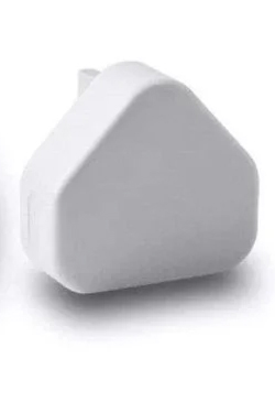

I want to use ESP32’s as BL proxies but the main problem is hiding them and providing them with power. There are a couple of ready made proxies on here and here but I dont know what hardware is being used. I had considered using a standard Apple style 2.1 amp charger like this

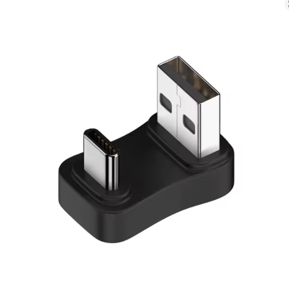

along with a USB A to USB c U adapter like this
with the Seed ESP32C3
to protect it it then requires a small cover probably 3d printed.
One of the considerations is the orientation of the USB A socket and choosing the correct U adapter from AliExpress and ensuring the reach of the adapter is sufficient to clear the plastic housing of the apple charger. Has anyone done anything similar and did you have any obstacles to overcome?
