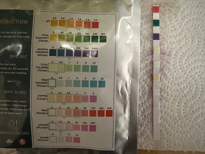

Semi-automatic water parameters testing
From this:
To this:
The process is the following:
  • Take a sample of the water using the test strip;
  • Take a photo of the strip and the reference values on the packing;
  • Upload the photo to Home Assistant directly from the phone;
  • The photo gets sent to an LLM engine for analysis;
  • Parsing the results and feeding some sensors with it.

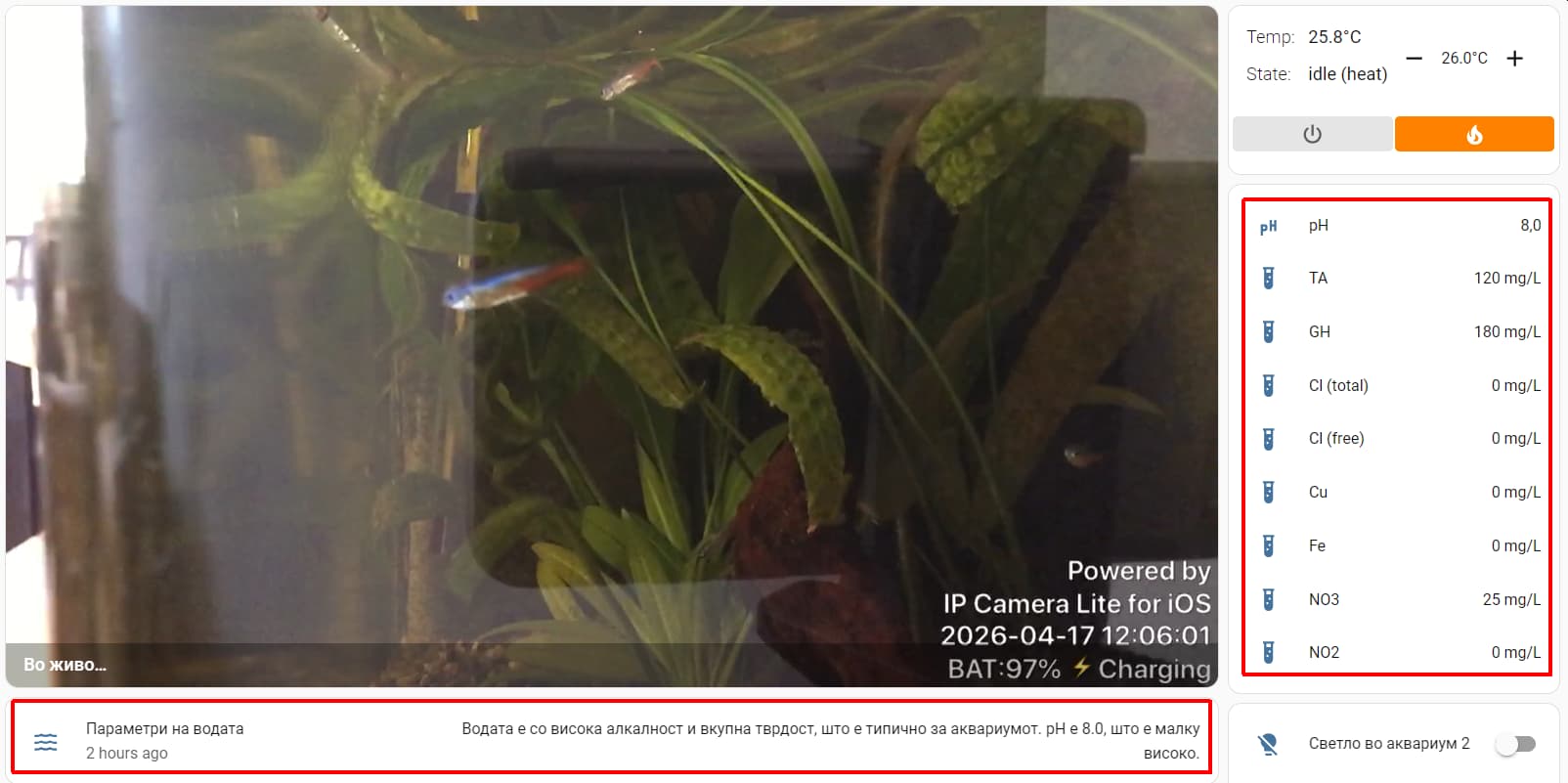

  • MQTT - I find it easy to create a manual MQTT sensor in HA and the use MQTT Publish to feed it with data. The short text status is the sensor value. The actual measurements are fed into the sensor as attributes.
  • Template sensors - To extract the attributes into separate sensors.

  • The folder watcher fires up several event on file upload. That last one in the sequence has event_type: closed. This is the one we want.
  • There are two trigger clauses in the automation, but only one is enabled. Started this project using event.received but this ended being unreliable. Events would fire, but the automation wouldn’t tigger. I moved to older event type trigger and everything works now. I might need some work in the future is i add more folder watchers.
  • There is a condition in the automation that checks for existence of response_data.response_text in the result. This means that llmvision.image_analyzer returned an error. This error is then populated into the sensor as value. Otherwise, parse the result and populate the sensor and the attributes with the response data.
