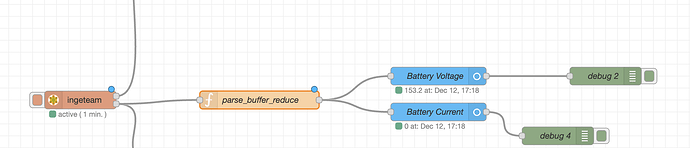

This is how it currently looks with two nodes:

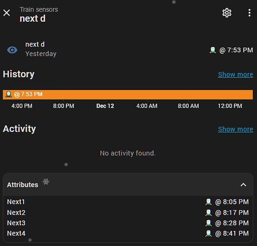

Well for the energy dash, you’ll want individual sensors. In other situations You can add as many attributes as you want.
I saw I can add attributes, but they do not allow to set the unit or the type, which is kind of key for the energy dashboard to pick those up.
