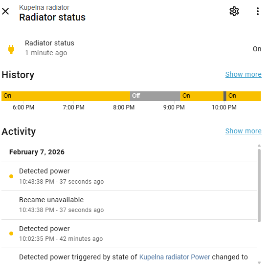

I monitor heater power usage and created template sensor to show status on/off.
Is there any way to triger alarm when heater is plugged in more them 5 hours and the status sensor was one or more times “on” every hour in past 5 hours?
