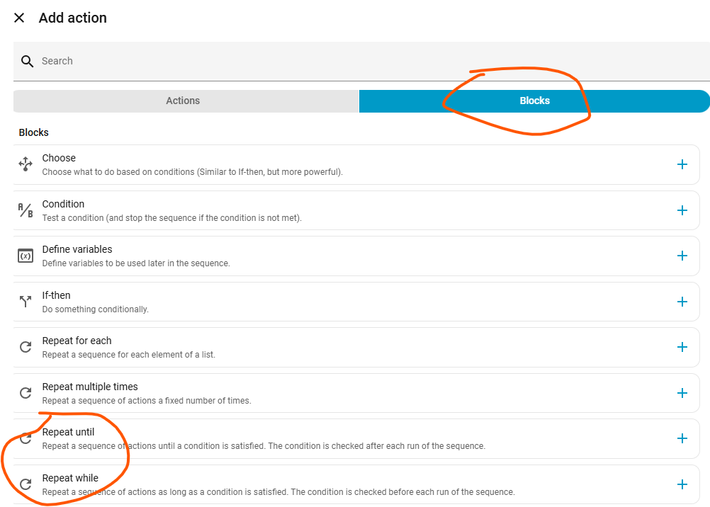

It’s also in UI building blocks
I used UI building blocks but couldn’t find it there. Can you tell me where?
Thanks, I found it, and everything works fine. Except for the time delay function. If I set the condition “Sensor equals ON” for a duration of 5 minutes, the action isn’t executed. Only if there’s no duration, the action is executed immediately. It would be great if I could wait 5 minutes after the sensor is set to ON before the action is executed.
