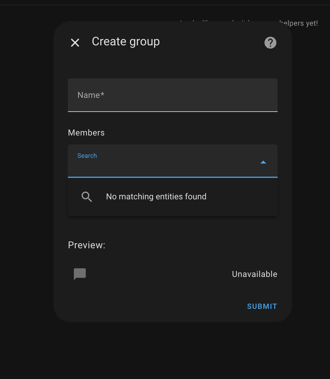

what is the best way to configure automation like the alarm is gone off, right now i have to create 5 lists on each automation that i need to send notifications to my family, i tryed using helpers but they dont show my devices

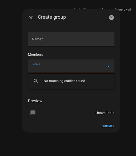

Notification integrations are in the middle of an overhaul.
Most notifiers are still using the platform-based method and can only be grouped via YAML configuration.

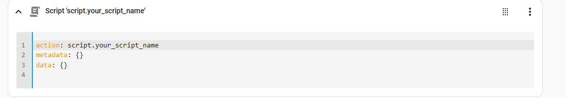

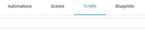

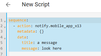

use a script for the sending notifications, call the script in your automations
