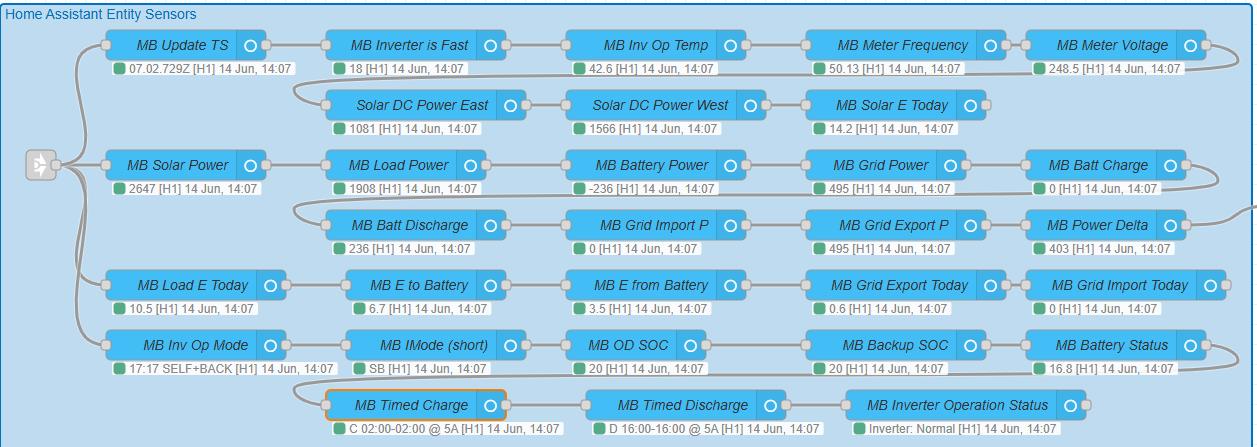

I just create a string in msg.payload and place that into a ha-websocket created sensor state or attribute.
A sensor entity has to have a primitive value (string, number, boolean) in the state, but HA stores them all as strings anyway. The state string limit, I think, is 255, but it works nicely for "Schedule finished"
The entity "MB Timed Charge" for example has a string for the state, containing the inverter charge times and current.
Display the content of that sensor as a template in a markdown card
