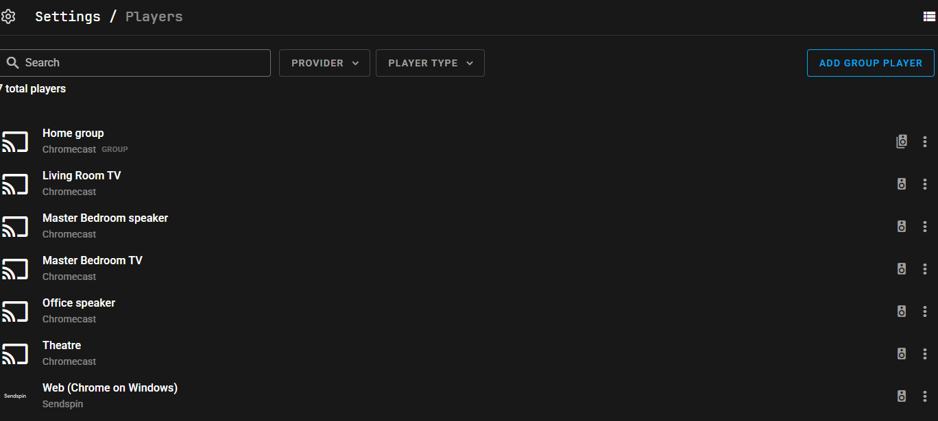

Running 2.7.2 Music Assistant and under Players I have all of my Chromecast devices listed (5), but when I try and create a group in Settings / Player section to put them all into one group under Sendspin it only list my "Web (Chrome on Windows) device and non of my Chromecast device?

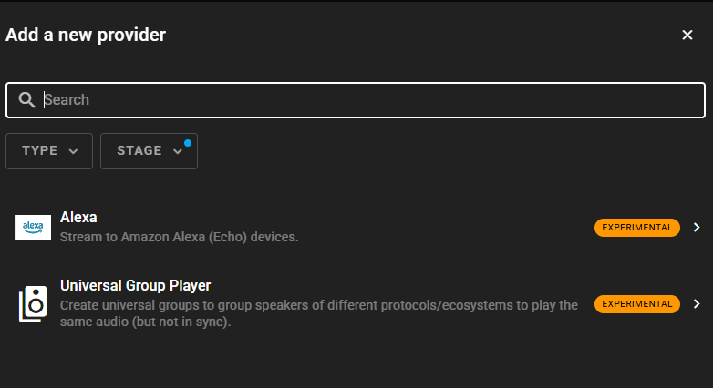

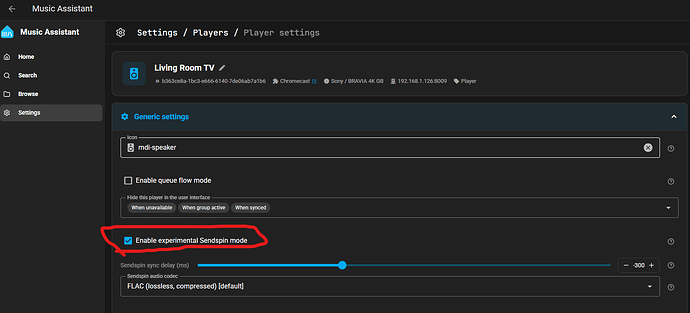

Found this option but it did not seem to do anything when I installed it… :man_shrugging:
Does chrome cast show as send spin?
If you create send spin group can you add chrome cast to it?
I found this option that is under generic settings and Enabled it on all of my Chromecast devices but it still will not let me group them all together.

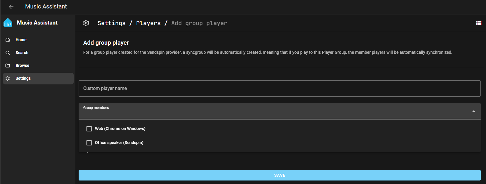

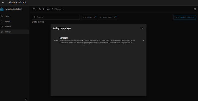

Trying to create a new sendspin group but it just doesn’t list my devices just the two that you see in this screenshot:
try restart music assistant.
if still no good, maybe its the “alpha” label and its still not working well
maybe someone can confirm it work/not work. :man_shrugging:
Thanks for trying to help :+1: I have tried restarting MA and HA and no luck. I will hook back up my Sonos units and see if MA lets me group them under Sendspin then I will know if it is a Sendspin issue or a Chromecast issue.

I added my Sonos S1 Connects (3) back into HA and then tried to create a Sendspin Group Player with them and it still just shows me the 2 Web devices. I can of course create a Sonos S1 group just fine in MA but not a Sendspin group.
You need to add the setting in your cast speaker setting then go to speaker icon button thing and press the power button it will then show up, The cast speaker will turn off after use and the sendspin will disappear again until you turn it on.

Sendspin is implemented in the stable version now. I have not tried Google cast stuff as I don’t use them anymore. But until the speaker is powered on sendspin did not show a player. Click the speaker icon in the bottom right. Find your speaker and press the power button.
Got it working! Thx Arh! It was that Power on thing you mentioned that got me looking in the right direction. That is probably a bit confusing for average user to have to do that in order to get it to work properly but it is still a work in progress I guess. Now to test it out for a while and see how it works before I put my old Sonos Connects up for sale.
