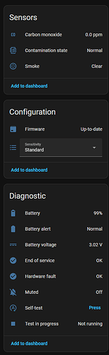

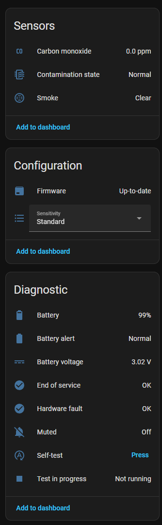

In Home Assistant it exposes te following sensors with firmware 1.4.0-0
I got two units myself and one of the units does not expose the Carbon monoxide sensor to HA. Have reached out to Sensereo and will let you know what their response is.

Got a reply from Sensereo support regarding the missing entity in Home Assistant.
We checked with our test engineers, and during previous batch testing we occasionally observed similar behavior in a Home Assistant environment. Based on our experience, this may be related to the current Home Assistant environment rather than a hardware issue.
Could you please try the following steps:
  1. Remove the affected MSC-1 completely from Home Assistant.
  2. After removing it from HA, perform a full reset on the device.
  3. Once reset is completed and the device is back in pairing mode, try adding it again.
Sometimes a clean removal plus a full device reset can resolve this type of issue.
Following these steps the missing entity was now visible. And the issue was solved.

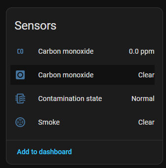

Just got mine today. Before trying this, I did a re-interview in Home Assistant and the CO sensor came right up.
With the 2026.3 update of Home Assistant a CO alarm state sensor got added.
Second one from the top.
