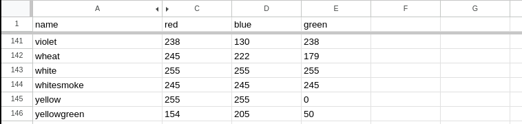

As an example, this sheet:

Returns the following response in the Action tool:
range:
  - - wheat
    - 245,222,179
    - "245"
    - "222"
    - "179"
  - - white
    - 255,255,255
    - "255"
    - "255"
    - "255"
  - - whitesmoke
    - 245,245,245
    - "245"
    - "245"
    - "245"
  - - yellow
    - 255,255,0
    - "255"
    - "255"
    - "0"
  - - yellowgreen
    - 154,205,50
    - "154"
    - "205"
    - "50"
From that, let’s say I wanted to get the “red” column value for yellowgreen. The template could be any of the following:
{{ sheet_data['range'][4][2] }}
{{ sheet_data['range'][-1][2] }}
{{ (sheet_data['range']|selectattr(0,'search','yellowgreen')|first)[2]}}
