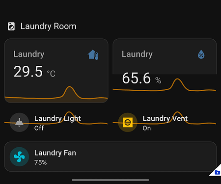

Hello, I am new in HomeAssistant, after many months of searching with no solution to my sensor card graph line overflow to other cards.
Refer attached, when editing dashboard, the card looks fine, after clicking done and back to dashboard view, graph lines overflowing to other cards.
Please help or point me to the possible solutions.
Appreciate and thank you!

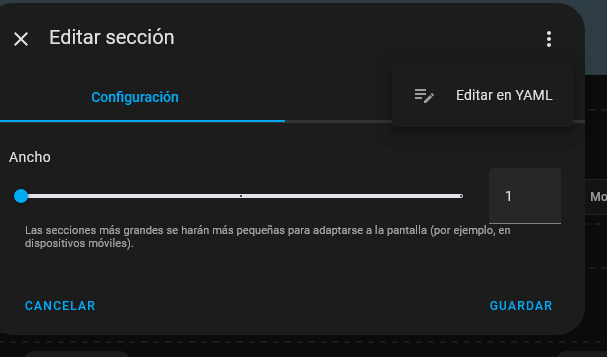

can you edit you post click this
Screenshot 2025-07-05 at 10-05-18 Sensor card graph line overflow to other cards - Home Assistant Community
and then paste your yaml , so we all can see if is a error in your code

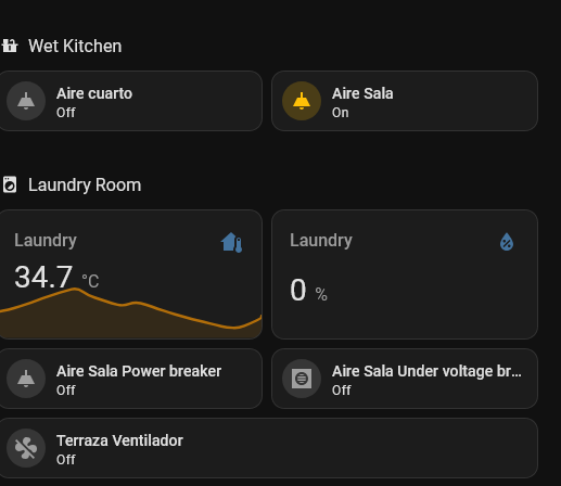

I’ve seen it look like that on my android phone all the time…
I don’t mess with the UI stuff at all, no custom cards. No sections stuff.
Lease give me a MINIMAL code to reproduce the issue. The code provided above seems to contain some cards which are not shown on a screenshot.
In my case I only see it on mobile Android (and just sometimes at that. It won’t do it now…), never in a Browser so I don’t know that code would help.
Now I see it is only happening when I am using HA Apps (Android), assessing through Chrome on Android looks fine.
Thanks all for the tip.
