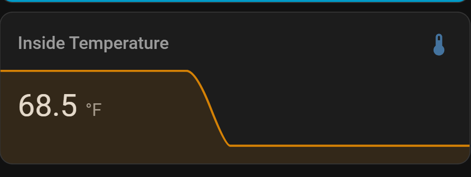

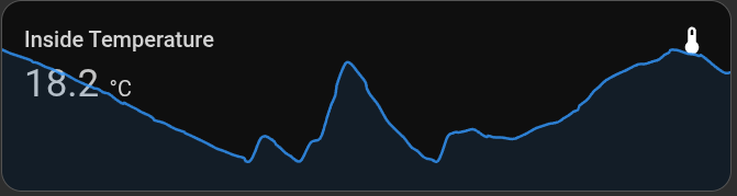

When I use the sensor card with the new Sections layout, the text and the graph for the card are displayed over the top of each other, like so:
It’s Awesome!!
_

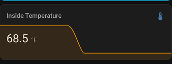

But when using the old Masonry style layout, the text gets chopped by the graph, like so:
It Sucks!
_
Even with the underlying yaml exactly the same:
(I know I don’t need card_mod: in the Sections layout)

Anyone know how I can make the old Masonry style layout have the text over the top of the graph?
I’ve been trying to migrate all my layouts to the new format but I just can’t quite get the layout I like just yet, so some screens are keeping the old type: custom:grid-layout
Sorry, I am not getting, is this code with card-mod was used in Masonry which caused the clipped text? Or you get the clipping without card-mod?
I don’t use card_mod with the Sections layout and it works great, I do use card_mod with the Masonry layout and get the clipping. If I don’t use card_mod then I can’t control the height of the card in Masonry layout.
Changing a card’s height with card-mod may cause undesired effects in many cases. What is a reason of using card-mod in masonry, only to set a smaller height? Cannot test it right now, but I am afraid this card behave differently inside a section; to get same look in masonry you will probably need more styling with card-mod, not just setting a fixed height.
Also, a remark for other people, this is not an “old” type, this is a custom layout-card.
Thanks! Yeah, I only use card_mod to set the height accurately, no other reason. I made these layouts years ago! Do you know a better way to set the height in a Masonry layout?

Test this out for your Masonry layout
card_mod:
  style: |
    ha-card {
      height: 140px !important;
    .info{
      margin-bottom: -90px;
Interesting that this clipping happens in masonry… Some research is needed)
Sections applies a fixed footer and Masonry does not. That alters the card’s layout significantly.
class="with-fixed-footer type-entity"
Still playing with it
Good findout. Can these changes be simulated in masonry? Or it turns to be same margin-like way?
Yes if you apply a position:fixed or absolute to .footer {
@LiQuid_cOOled That is working at my end too! Thanks man! :partying_face:
