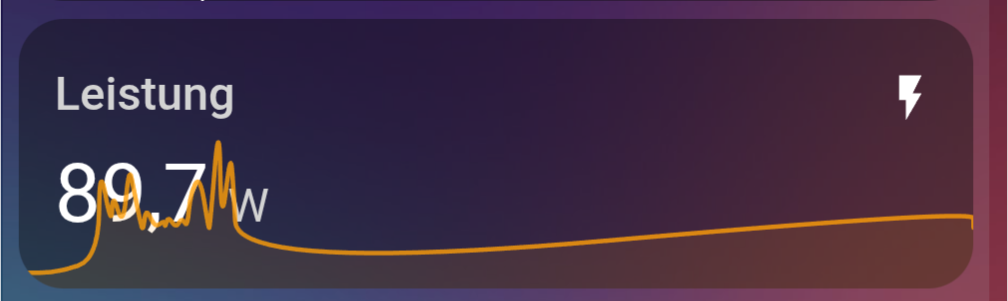

Is it expected behavior, that a sensor card line graphs get stuck on the last sensor value change and only “stretch” the graph to the left over time representing anything but the actual configured “Hours shown” value?
This is a power sensor sensor card and on the right side the line just got stuck, since the device was turned off. On the left, it seems to stretch the graph until the last time the device was turned on.
Thus, the graph appears, as if the device ran for about 18 hours and was turned off just minutes ago…

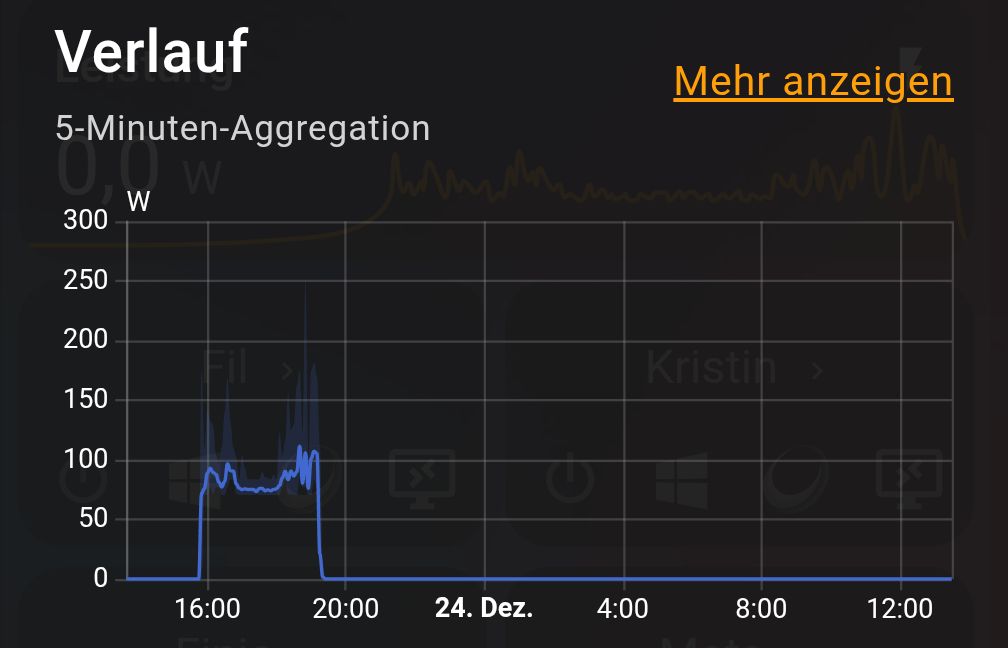

… but it actually ran only about 2 hours and was turned off about 19 hours ago:

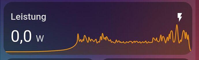

If I turn on the device, the graph suddenly “jumps” 19 hours to the left:
