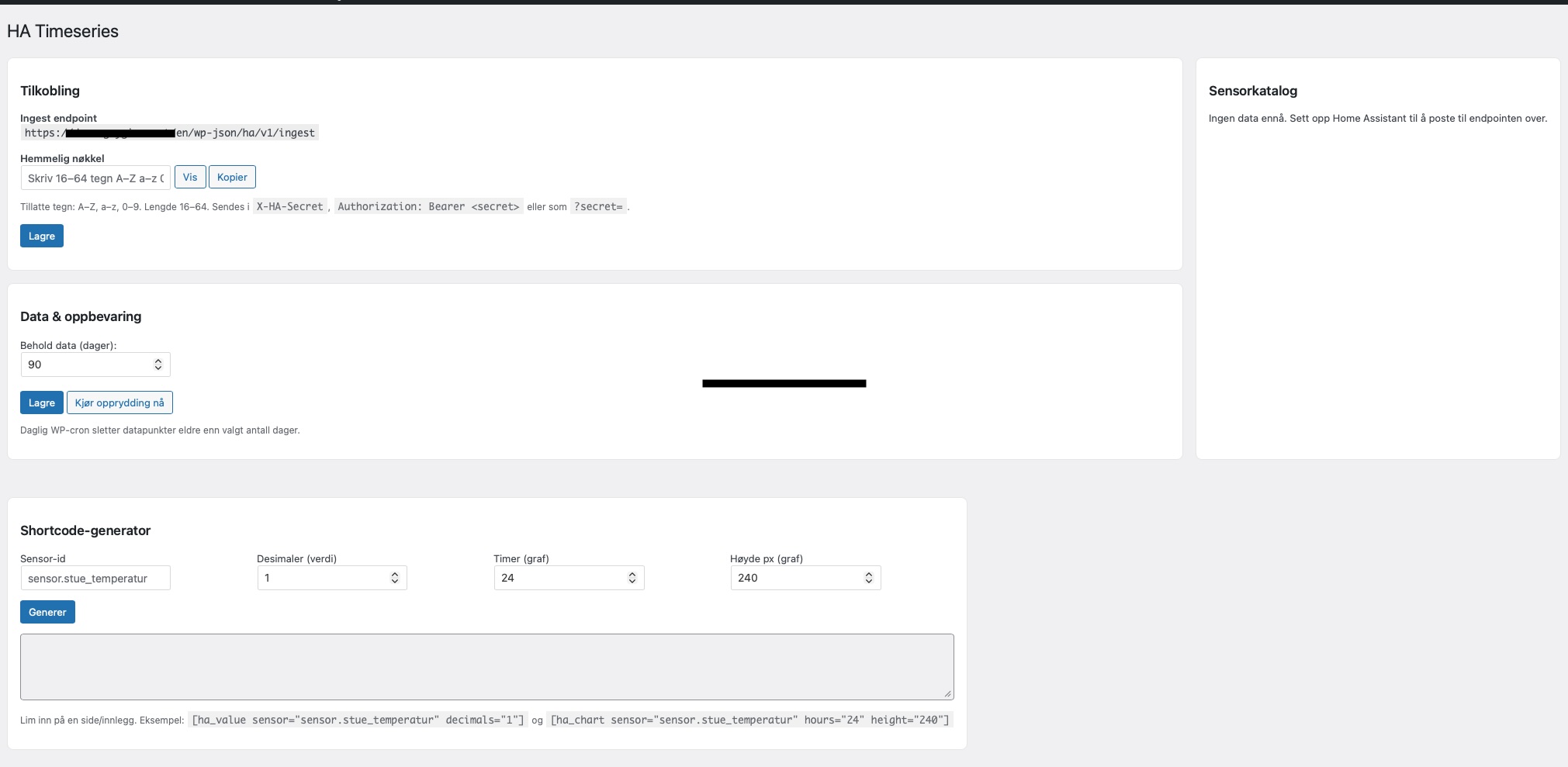

I am using a Raspberry Pi3/HA setup to - among others - keeping an eye on temperature and humidity conditions. Secure remote access to HA is possible, however I wanted to have data easily accessible and nicely displayed on a WordPress site. I ended up building a WordPress plugin that uses data HA is pushing to present both values and graphs.
The WordPress plugin itself is pretty straight forward in terms of use with generation of secret key for transfering data and short codes for displaying.

Backend WordPress

Hi!
Home Assistant pushes data every 5 minutes to WordPress.
Data is stored in the Wordpress database for 90 days (by default).
For the transfer, I use both a secret key and an application password.

Apologies for the lack of detail. I got the impression you wondered about the bigger picture.
After activiating the WordPress plugin (which is in its beta stage), configuration.yaml has to edited in order to allow an automation to submit data to WordPress. URL and secret have to be defined in secrets.yaml.
