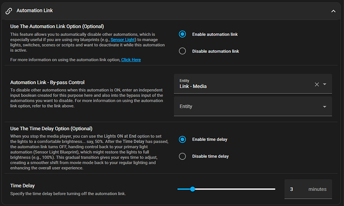

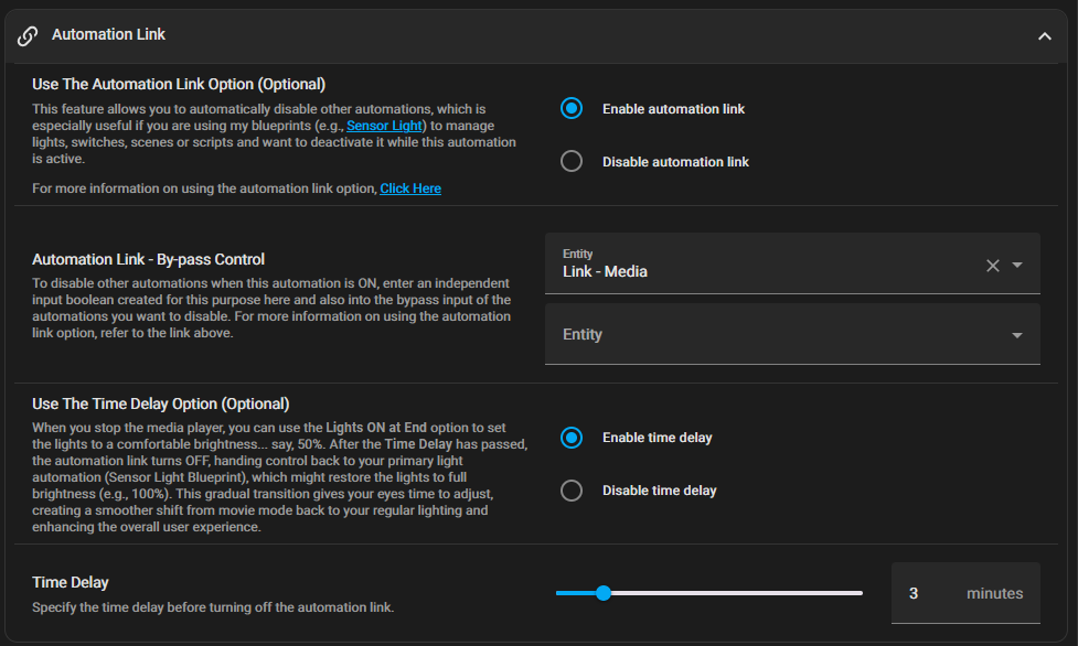

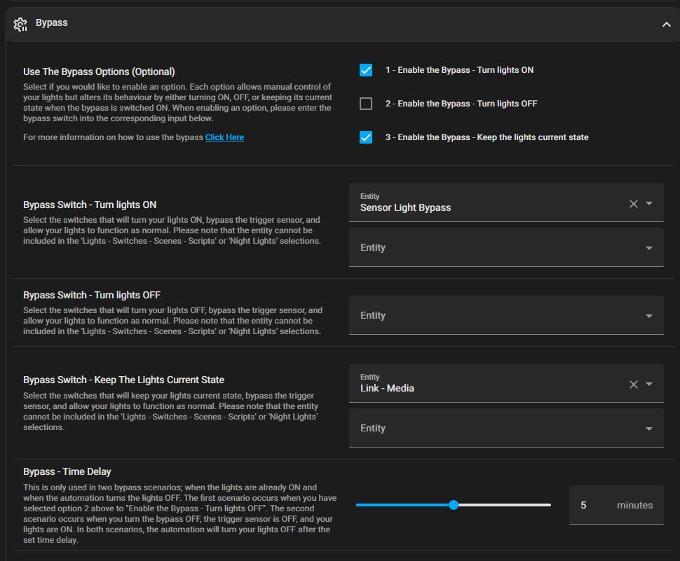

I seem to have another issue now, when I turn off the media player, I’ve set it so the intermission lights turn on, but it never reverts back to other Sensor Light blueprint, I’ve got the automation link setup, with the bypass set on the Sensor Light blueprint.
I’ve also noticed if I have option 3 set that the Sensor Light blueprint generally doesn’t execute but it’s fine when I disable option 3.
Automation Link;
Sensor Light Bypass;
@MrBoofuls
I tested it here so when bypass option 3 is turned OFF the lights should adjust to the sensor light blueprint. If they are different lights then it wont turn them OFF so make sure it is the same lights used in Lights ON at End and your Sensor Light blueprint if you would like them to change. Also note you have a bypass 1 entity Sensor Light Bypass is this ON? as all bypasses must be OFF.
Blacky :grinning:

When I set 3 - Enable the Bypass - Keep the lights current state To on, watch something the lights don’t seem to revert back so I have to manually turn off as it doesn’t switch back to the other automation.
It also won’t trigger after and turn the lights on when motion is detected but if turn off that bypass all is good.
I’ve removed the other bypass so I don’t think that is interfering atleast.
@dmob69
You will need to look into developer tools to see what is happening. This is a FAQ that will help you click here
Blacky :grinning:

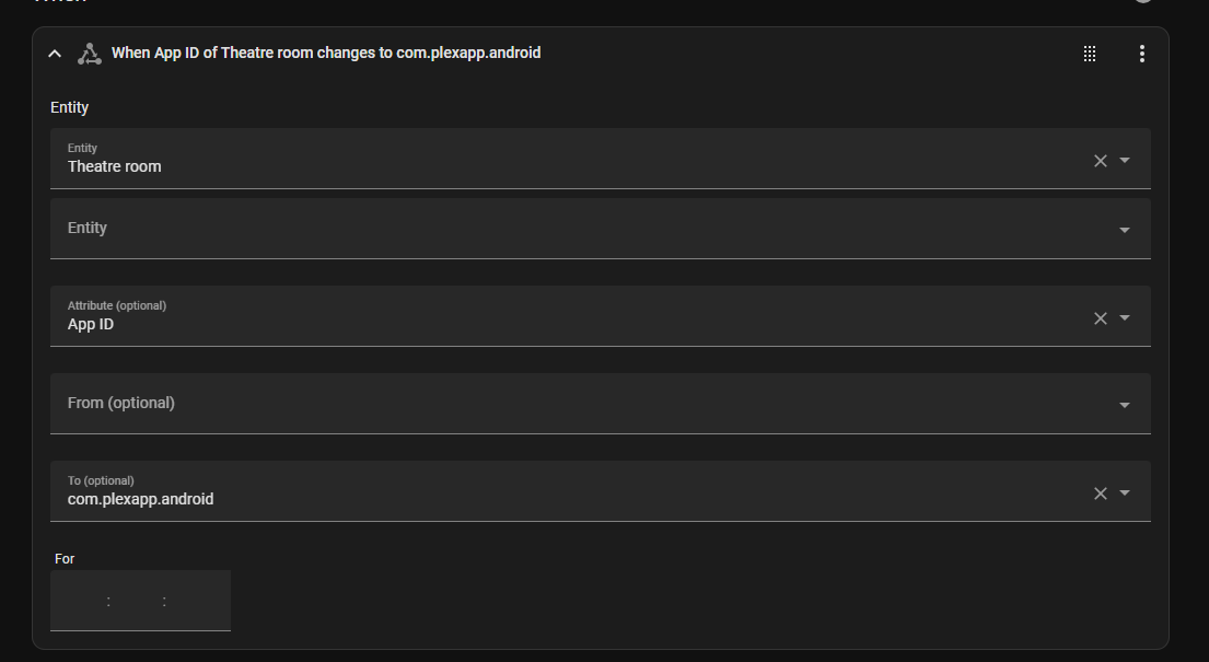

Hi there,
I am looking to utilise this automation. I am using the plex chromecast option and am wanting to know if it will work with my tv. I currently use the below to turn the lights off:
thanks King
