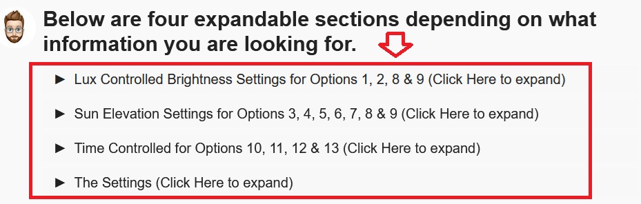

In the Dynamic Lighting section, there’s a link:

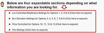

For more information on dynamic lighting settings Click Here
That link takes you to the FAQ on the forum, where you’ll find helpful graphs and more details. Be sure to expand the relevant section to see everything, as shown in the example below.

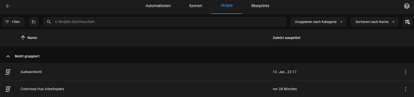

Hi Blacky,
  1. the night lights working so far. And it wasn’t night, the automation was turned off.

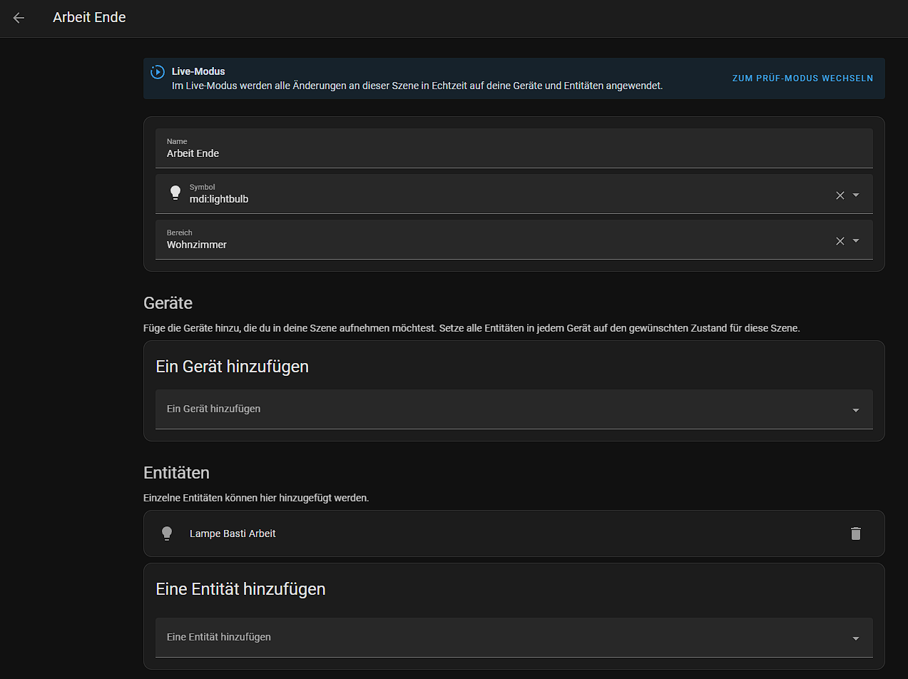

  2. As for the scene to turn off the lights, you can see, that the lamp is turned off in the scene.
  3. with the lights cranked to 100% and a bright image from my monitor, I usually have 520 to 550 lux. I have learned that you should have at least 500 lux in your working space, when working with a computer. So thats why I have this range minimum 500 to 600 lux.
  4. Thats correct and the way I want it. I don’t need the lights being on, when I am not working on the computer.
  5. That is also correct. I want the lights to stay off or turn off if the computer is also off.

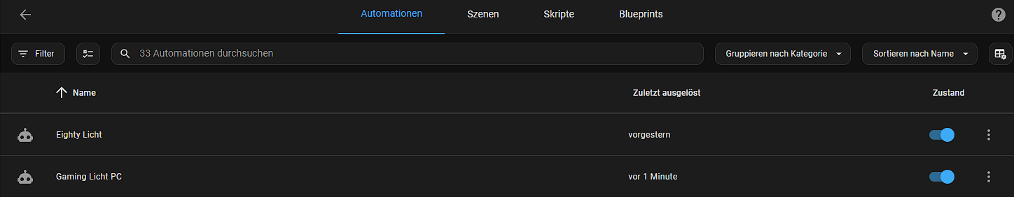

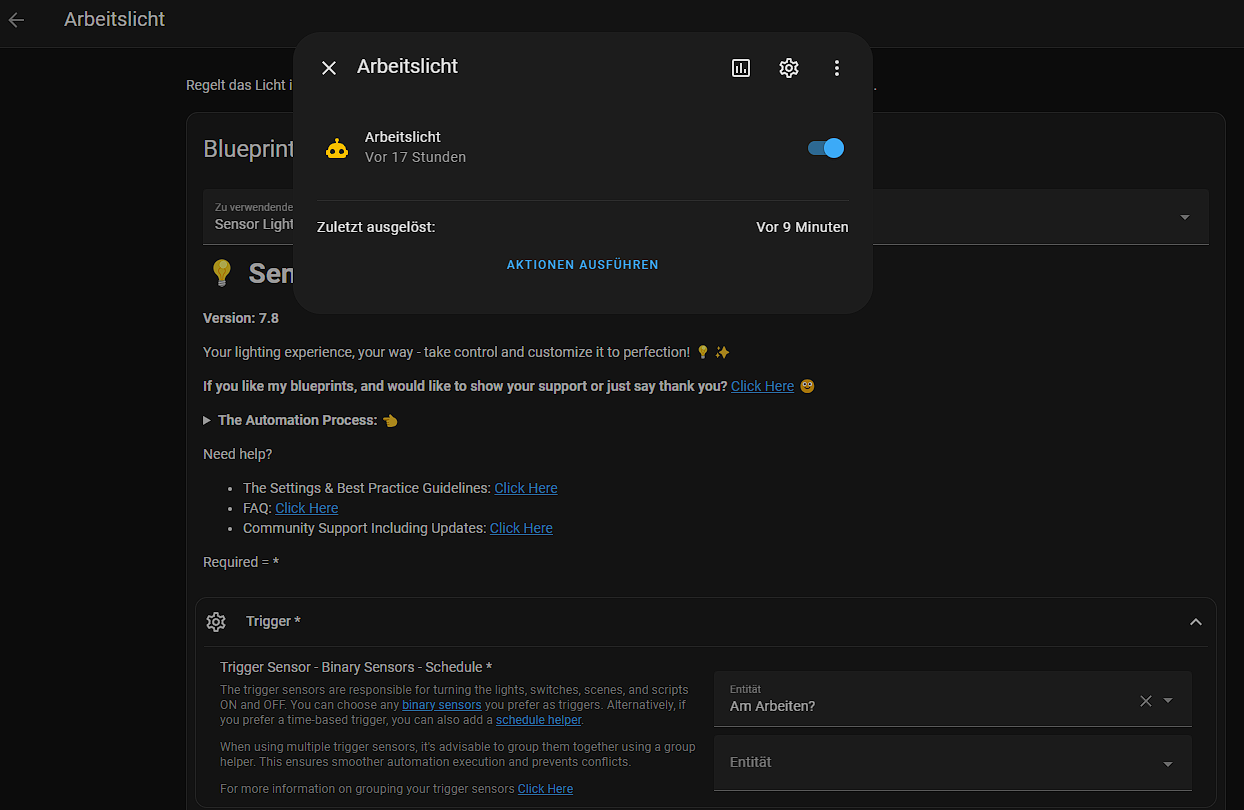

But right now I started my gaming PC. And both automations for working and gaming lights started, with the working lights being the one handeling the lights.

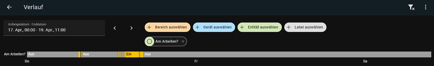

I checked if my binary sensor for working was activeted but it says it was active last time two days ago:
But the automation started:

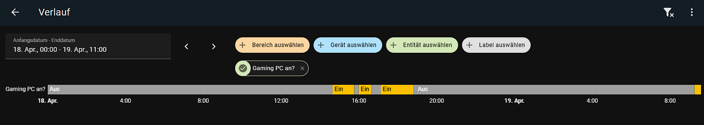

The binary sensor for gaming was active:
Or right know. I restartet my gaming PC. In HA I can see, that the automation was triggered:
But the light did not turn on. So I checked the script to start the colorloop. It was not activeted with the automation:
If I activate the script manually, the light turn on and goes into colorloop.

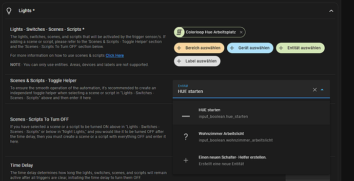

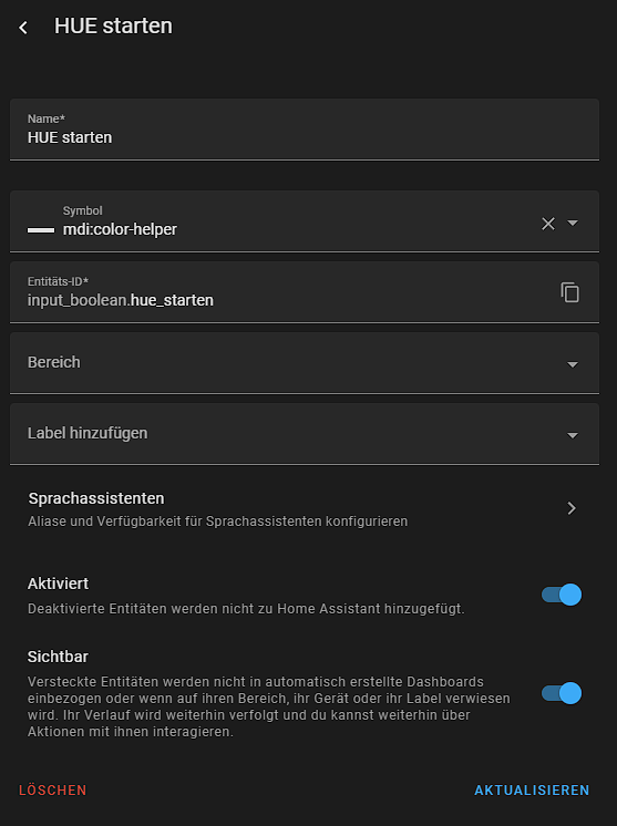

So maybe something isn’t right with the toggle helper?
I created that one through your blueprint.
I lokked at the code, and see, that there is a ā€œend_sceneā€ which I can’t even remember to put into the automation. I can also not find it anywhere in the automation in GUI style. But the end_scene I actually put in through the GUI is not mentioned in the code.

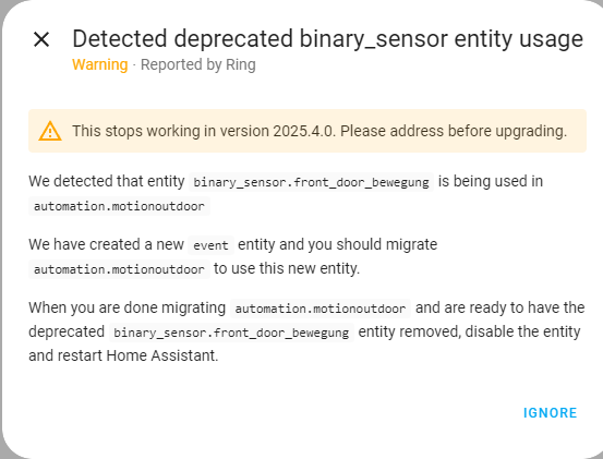

Been using this blueprint for a while but now Ring complains about it:
I filtered the entities for events and Ring now uses
Name                     Entity ID    [....]
Front Door Ding     event.front_door_ding
Front Door Motion  event.front_door_motion
Is it possible to update the blueprint so the Ring events can also be selected instead of sensor_binary?

The trigger must have both ON and OFF states. If you’re using an event (such as motion from a Ring doorbell), consider creating a template binary sensor.
