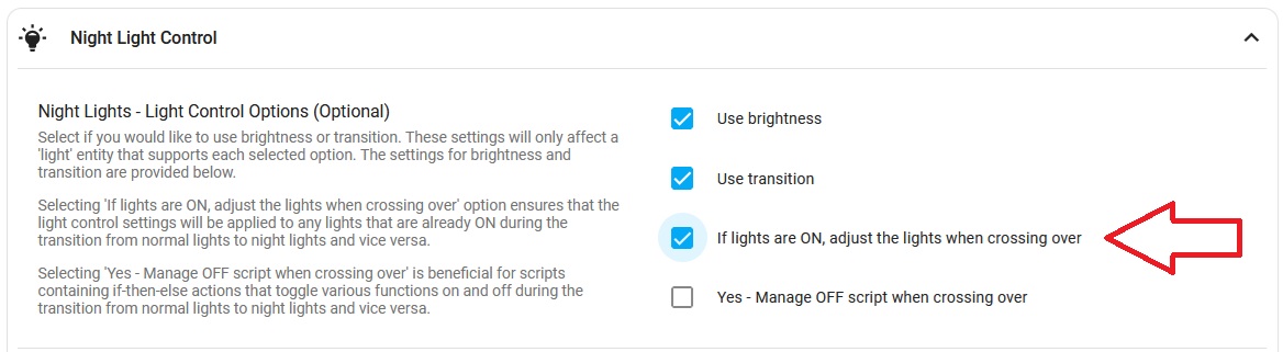

Hi Blacky! Thank you again for an amazing blueprint!
I’m finally getting around to implementing your blueprint with my RGB dimmable lights. You walked me through it a while ago but my objectives are:
  1. Motion from my motion group will turn the lights on to 100% to a specific color preset and then turn them off a few seconds after motion stops. This will happen any time day or night except for:
  2. During the time period of sunset until 10pm I want the same thing to happen but after motion stops the lights will go to 1% at a different color temperature.
The idea is that any time day or night that we walk into the kitchen the lights will turn on 100% and then off after we leave the kitchen, but from sunset til 10pm they will go to 1% dim to provide ambient light in the room.
Overall, it seems to be working in general, but it also seems like during certain times of the morning and/or early afternoon it does not. I am checking the motion group when the blueprint is not working and the group state is ON, and the blueprint runs, but the lights aren’t turning on. Your blueprint is so insanely complex and sophisticated but it’s also easy to miss a setting. I know that has to be the case here. I’ve been checking and re-checking the settings and trying random things, but nothing seems to solve my issue. Could you take a look at this yaml and tell me if you see something obvious? Thank you in advance!
alias: Kitchen Under Cabinet Lights MOTION
description: ""
use_blueprint:
  path: Blackshome/sensor-light.yaml
  input:
    motion_trigger:
      - binary_sensor.kitchen_motion_sensor_group
    light_switch:
      entity_id: light.under_cabinet_lights_light
    time_delay: 0.26
    night_lights:
    night_glow_lights:
    include_night_light_control:
      - use_brightness
      - use_transition
    night_light_brightness: 100
    include_night_glow: night_glow_enabled
    include_night_glow_light_control:
      - use_brightness
      - use_transition
    night_glow_light_brightness: 1
    include_sun: sun_disabled
    night_time_delay: 0.1
    include_light_control:
      - use_brightness
      - use_transition
    include_light_colour_control: use_rgb_colour
    light_colour_temperature: 8000
    include_night_lights: night_lights_enabled
    night_lights_conditions:
      - time_enabled
      - sun_enabled
    include_night_light_colour_control: use_rgb_colour
    include_night_glow_light_colour_control: use_rgb_colour
    night_glow_light_colour_temperature: 8000
    night_light_colour_temperature: 8000
    night_glow_light_transition_off: 7
    night_light_transition_off: 7
    night_light_transition_on: 3
    night_glow_light_transition_on: 3
    night_light_rgb_colour:
      - 255
      - 211
      - 147
    night_glow_light_rgb_colour:
      - 255
      - 255
      - 255
    night_lights_after_time: "15:00:00"
    night_lights_before_time: "22:05:00"
    include_time: time_disabled
    after_time: "03:00:00"
    before_time: "02:59:59"
    light_rgb_colour:
      - 255
      - 211
      - 147
    night_lights_sun_elevation: 0
    bypass_auto_off_delay: 1
@sorcer1

@JP505050
Your welcome!
Thanks for your description and YAML of your automation stetting, it helps me understand what your trying to do. You are so close. Try selecting If lights are ON, adjust the lights when crossing over Even though it is the same light / brightness / RGB it will force it over to nightlights trace.
Let me know if that fixes it.
Blacky :grinning:
