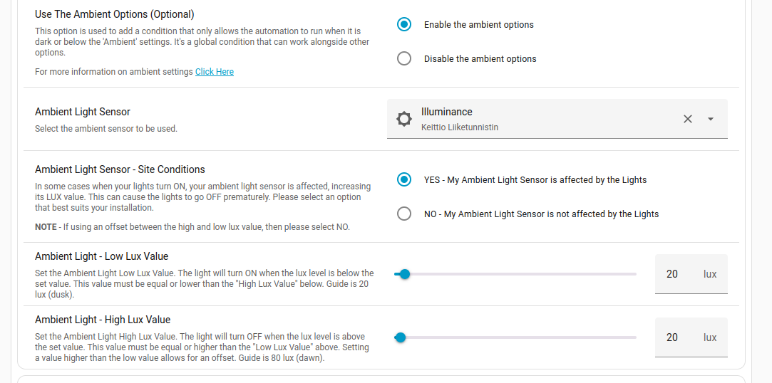

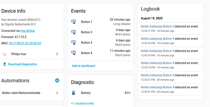

Hi folks!
Not sure if this is right place for ask but anyway:
I have a problem with bypass. For some reason bypass switch does not turn lights on or off no matter how I try to configure it. Here is the bypass setting:
So I have Hue switch and I can see that pressing button is seen by HA:
And ambient setting of the BP:
What am I missing? Do I need to create automation for the button or should it work when I add it to the BP?
