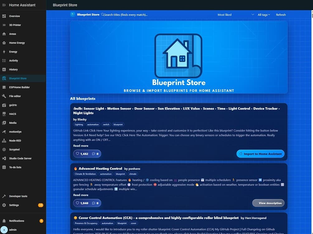

:face_with_thermometer: hey could you rename this blueprint lol, looks horrendous in my project
