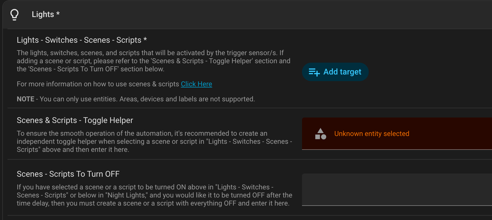

@Sn0rrii
This looks a bit tricky and you will need to test it because your MR16 hue lights are OFF so HA can see them until they are ON. The order of the blueprint is lights first then switches (not switches then lights) and this is milliseconds apart but that may matter.
I am assuming you would like and have the Shelly mini to keep power OFF to your MR16 hue lights.
Option to try in this order are;
  1. Add your MR16 hue lights into Lights with your Shelly mini and in Light Control enable brightness and set it to 20%.
If that works :partying_face: if not then:
  1. Create a scene with your lights at 20% and your Shelly mini ON. Use the scene in Lights - Switches - Scenes - Scripts You then need to add a toggle helper into Scenes & Scripts - Toggle Helper and then create another scene with all your lights OFF and your Shelly mini OFF then add that scene into Scenes - Scripts To Turn OFF
  1. Turn your Shelly mini ON and leave it ON… Then just control you MR16 hue lights in the blueprint adding them to Lights and in Light Control enable brightness and set it to 20%

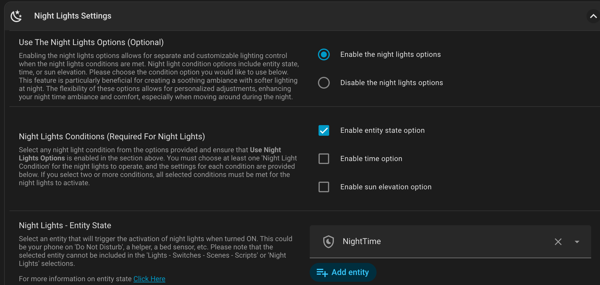

Also from my side thanks for this awesome blueprint! One issue I’m running into which I cannot solve. I only want to have the lights switched on during night time when motion is detected.
I’ve set the Night LIghts configuration as per screenshot below.
The main lights configuration is left empty:
But the automation is never triggered! Only with a light has been added to the “Lights” config then the automation is triggered. What am I doing wrong in the config and/or how to solve this?
My goal is to only have the lights on when my helper “NightTime” is true and motion is detected. Thamnks.

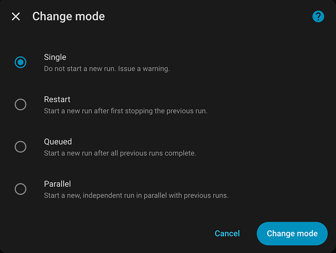

Two questions. First, I recently cleaned out some Helpers that I thought weren’t being used and I didn’t recognize, but I am now seeing a red error message “Unknown Entity Detected” message in the “Scenes & Scripts - Toggle Helper,” even though I am not using a Scene or Script here. I’ve tried reimporting the Blueprint, but am not sure if I messed something up and need to recreate a default helper (or if it can be reinstalled somehow), or if everyone is seeing this error message and it can be ignored.
Second, @Blacky I saw a story recently about the different Modes in automations, and in my case, would prefer Restart vs. Single mode for my light automations, that way detecting motion would restart the clock rather than adding it to an ongoing timer. Is that how your Blueprint works, or is that a config setting I’m missing, or is that not an option for Blueprints like this? Just curious as I have noticed some lights seem to go off faster than my timer but only after I leave and re-enter the room a few times.
