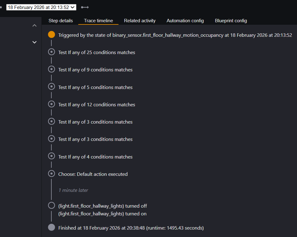

I’m experiencing an issue with my automation. The lights turn on when motion is detected and turn off after one minute of no motion, which works as expected. However, at the moment they turn off, they immediately switch back on again.
It almost looks like the turn-off and turn-on happen at the same time. After that, the automation remains in the “still running” state for about 20 minutes, even though there is no motion detected. I eventually have to manually stop the automation and turn off the lights myself.
Could this be related to dynamic lighting? Is it possible that when the timer finishes and the lights turn off, a dynamic lighting update runs at the same time and causes them to turn back on?
Would using the “dynamic toggle helper” help prevent this behavior?
Thanks in advance for any guidance.

My trace:
@Blacky, is there a chance to add this to the blueprint?
Adding helper solved this problem! Thank you for pointing this out.
