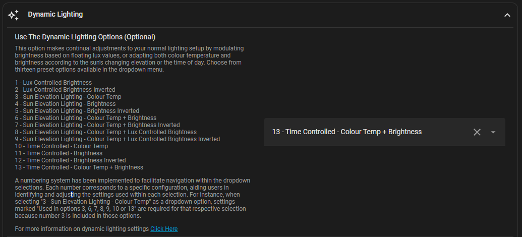

sorry if this was already asked in the thread but is there a way to adjust the color of the lights based on time of day or sun position?

So, there is currently no way to base the colour temp on the time of day and the brightness on the illuminance sensor? Would you consider adding this option?
(Or maybe separate this into two options: a ‘Dynamic brightness’ option that could be controlled by lux/sun/time and a ‘Dynamic colour temp’ option that could be controlled by lux/sun/time)
Here is my reasoning: I want the colour temp to be fixed everyday because it helps align my circadian rhythm with my daily schedule (I don’t want to go to sleep at 6 o’clock in winter and 11 in the summer) but the brightness should depend of the daily conditions.
