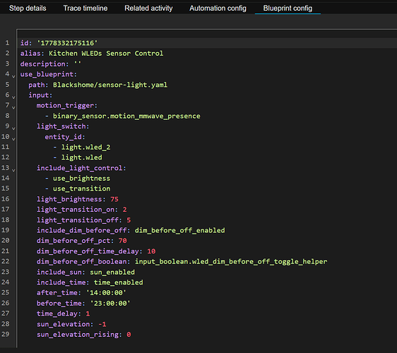

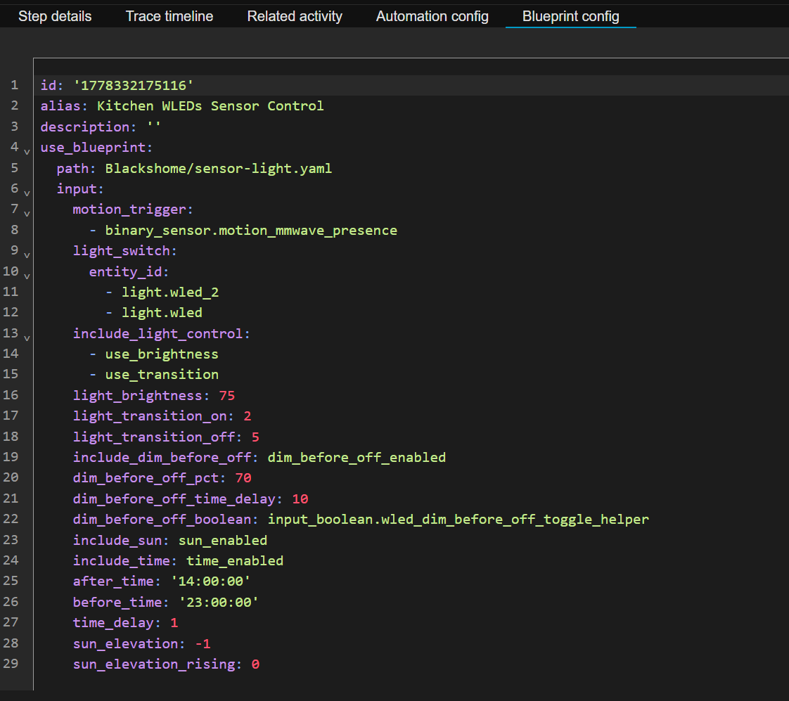

Hi, been trying out this (along with your Smart Light BP) and I've run into a hiccup I can't seem to resolve with the Sensor Light BP.
For my test automation I have a trigger which is a MMWave presence sensor and some WLED cupboard and plinth lights I'd like to turn on/off.
When the MMWave sensor triggers I'd like it to turn on the WLED lights. I have enabled "Sun Elevation" and "Time" controls enabled so I can test with either. However with both enabled, the Trace run fails on the Sun test (as it's during the middle of the day) and doesn't execute any further, so ignoring the fact the Time window is valid which I've set for the entire afternoon.
The BP says both are global and can be used together but maybe I'm misunderstanding that??
I've attached the BP config below.
Any ideas gratefully received.
