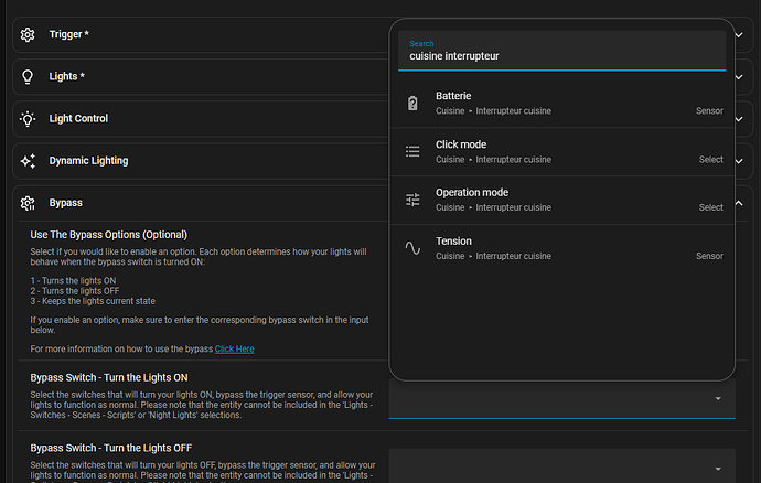

Hello @Blacky,
Thanks a lot for your very usefull blueprint!!
I have some lights controlled by a motion detector and it works great.
But when we have some guest, I would like to use the bypass functionnality but I don't find my desired switch.
I have installed a physical switch (Aqara wireless H1) connected using z2mqtt and all I find when I search this device is :
I don't find the actions when I press a button on the switch like I can select them on a standard automation.
I'm not sure if I understood how the bypass works.
Thanks for your help
@Charles26
Hi Charles, thanks for your kind words... your welcome.
You should be able to see all your HA entities... as there are no restriction (filters) on your selection. Have a look at what your switch is called and then search for this as currently your searching for cuisine interrupteur and it may be filtered out.
The bypass entity must be a switch with an ON and OFF state. The automation checks these states to determine whether the bypass is active. A button cannot be used because buttons do not maintain an ON or OFF state; they only generate an event, so the automation cannot determine whether the bypass should remain enabled or disabled.
All bypass options disable the automation when the bypass is turned ON. You can choose what happens to the light when the bypass is enabled by selecting option 1, 2, or 3.

Ok thanks so that's why I do not see it.
So I guess I need to create a new toggle and another automation to switcj the new toggle when I press on my switch.
In my case I want to be able to turn the light ON (or keep it ON if it was already the case) until I press on another switch to disable the bypass (so another toggle I suppose).
But I not sure if I can do that, it seems it only a delay can disable the bypass.
Do you confirm ?
EDIT : I'm dumb :sweat_smile:
After testing, I just need the first toggle and when I switch OFF, it automaticaly disable the bypass....
Thanks :slight_smile:

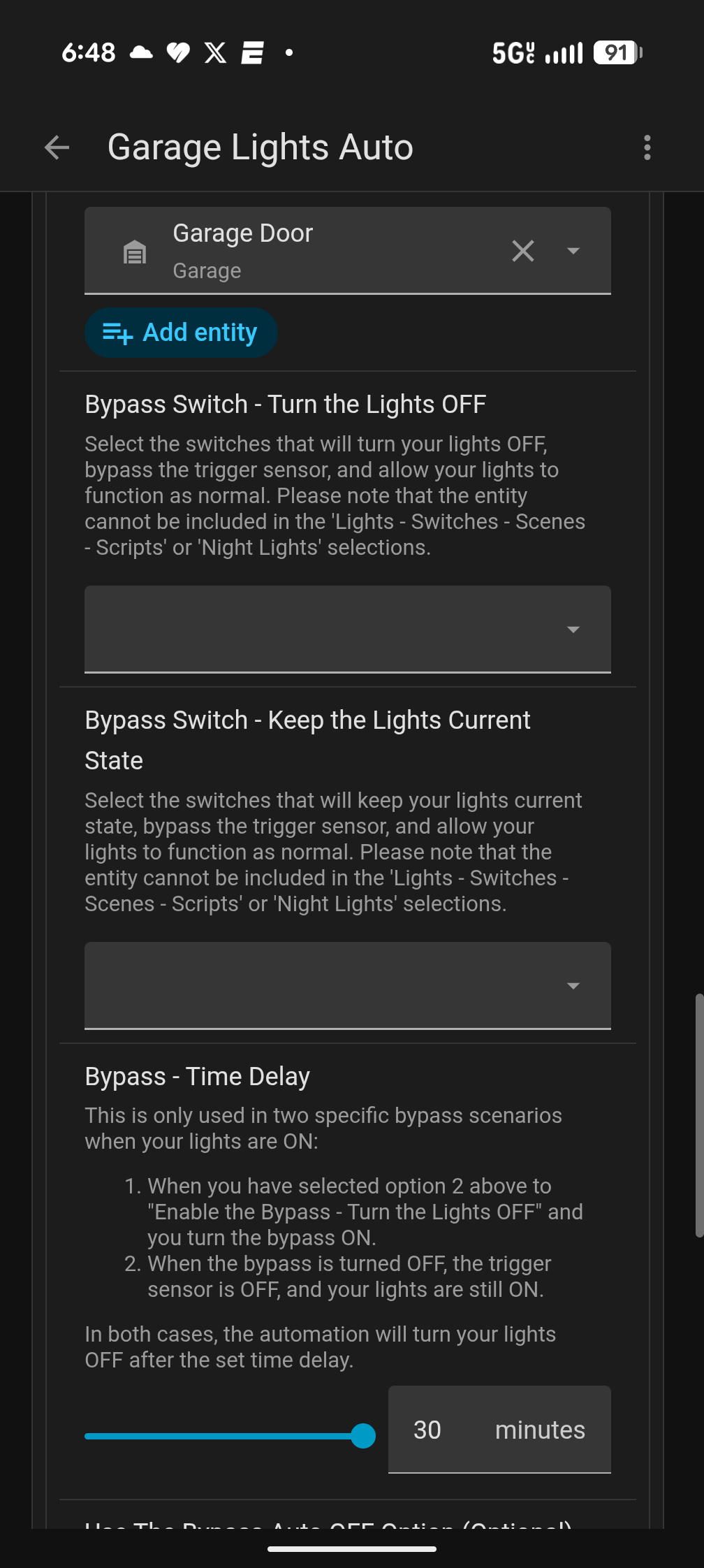

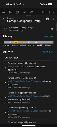

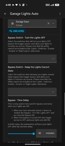

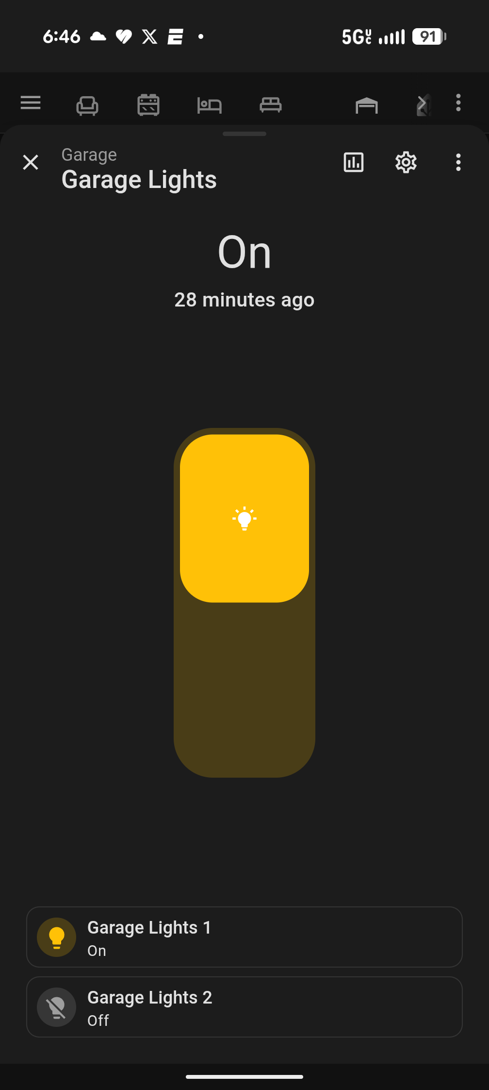

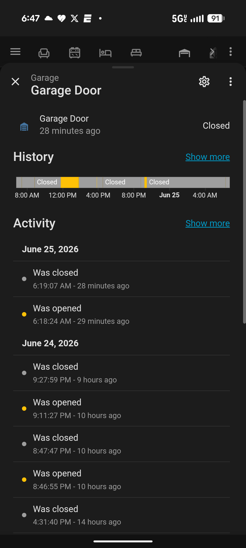

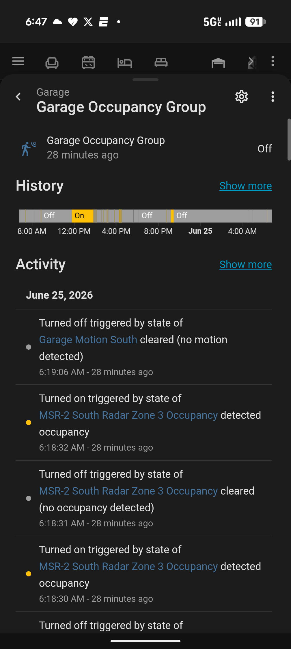

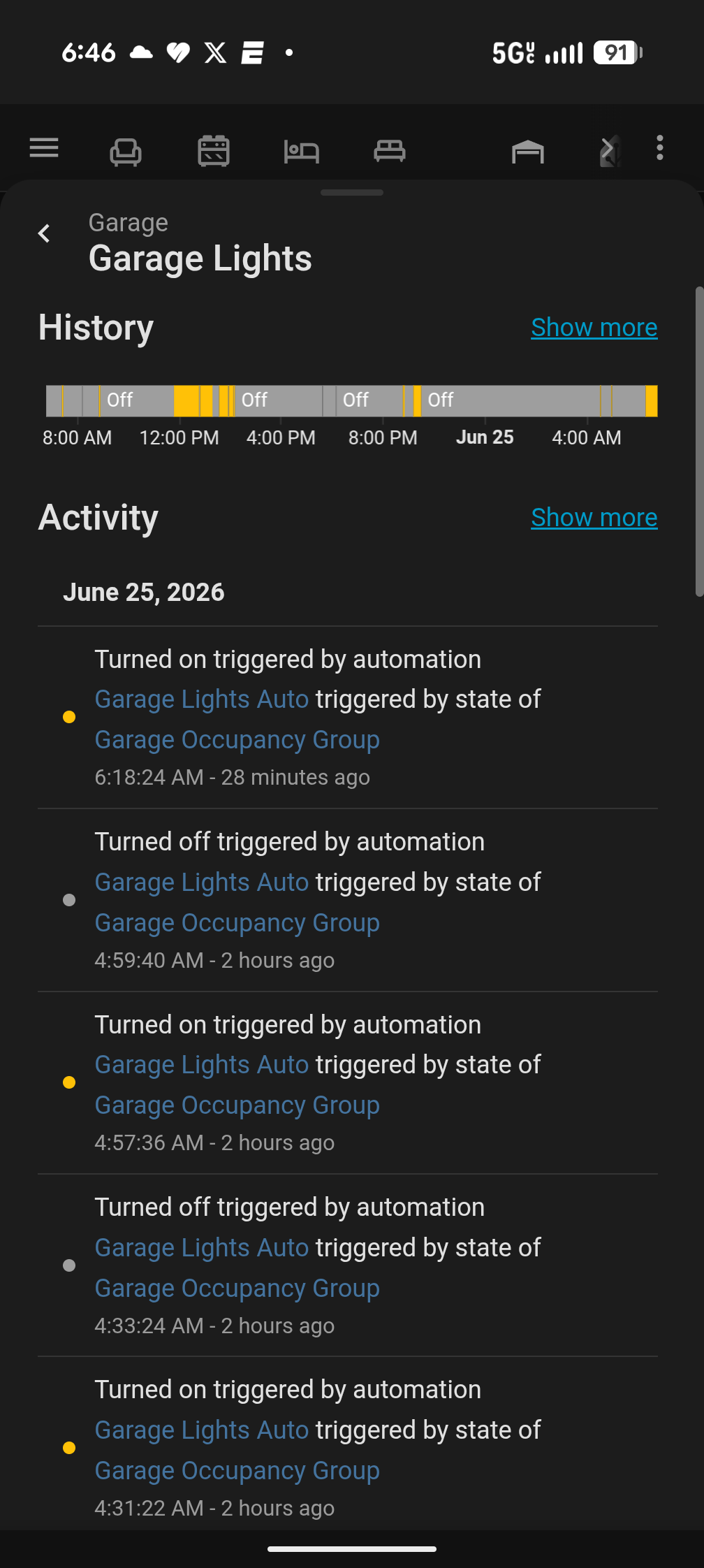

Hi, so I am using this for my garage.
I have two zigbee smart relays, named Garage 1 and 2, in a light group named Garage Lights.

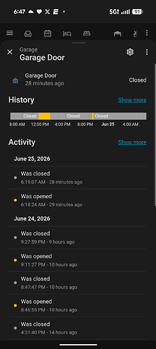

I have a zigbee tilt sensor on the garage door, when it's off, the main door is closed. I do not yet have a sensor on the "people" door. (My garage is a fully separate building from my house)
I have several occupancy sensors inside the garage, both motion and mmwave radar detectors.
I have those detectors all grouped into a binary group named Occupancy, and when it is on, it has detected some form of occupancy.

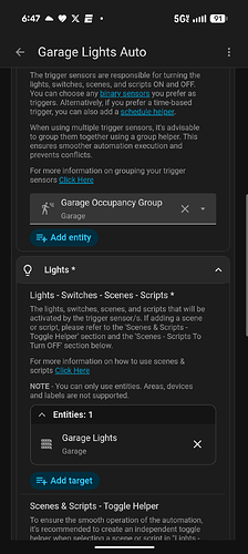

Now. I have the group for the lights set as the Light to be affected, the sensor is the occupancy group, with a 3 minute delay there, and I have the bypass set for the garage door, with a 30 minute delay, as I want the lights on if the garage is open, but if it stays open for more than 30 minutes without occupancy detected then turn off.
Now, I just looked, and one of my garage lights is on, the other is off, it's been on for 29 minutes and the garage door is closed.
What gives here?
Edit to add: I had it working better, but without the 30 minute delay (just left it on no matter how long the door was open) when I had it set up using several different automations, but switched to this blueprint to add that final bit and to consolidate some automations.
It did finally turn off after 30 minutes, but 30 minutes after the door was -closed-
Might be just a miss with the light command. I have one light, Tuya interface I think, that will occasionally miss a command. I just added two commands to turn the light on in the automation, and two to turn it off. With a small delay between each. Not an elegant solution but it works.
