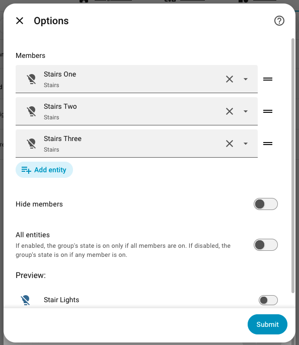

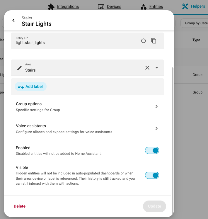

Hey, Blacky. Thanks for all the help; sorry I’ve been absent, unavoidable family crises.
I’m using a group entity for the lights. Here are its settings and options:
The three members are all Ikea Kajplats bulbs using matter-over-thread, and their configurations each look like:

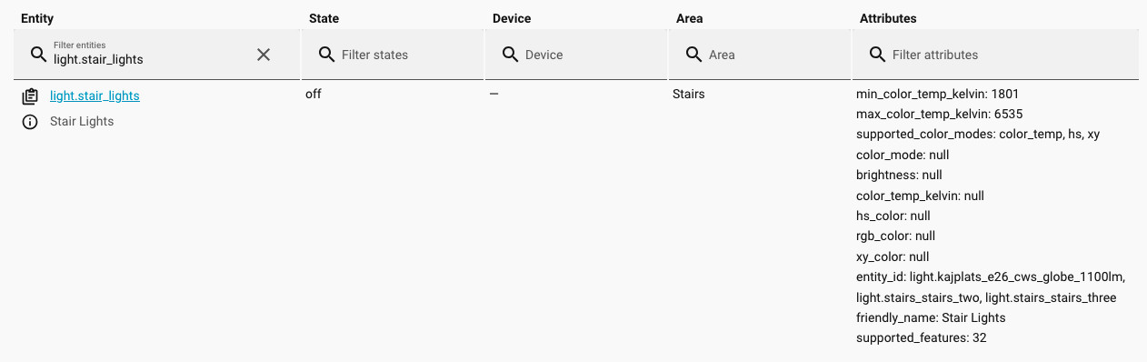

Finally, you requested the attributes. They are:
@judebert
No problem, hope all is well.
In you attributes you have brightness and supported feature 32 (white value) or RGBW. Transition not in the attributes.
In you configuration you have transition settings for OFF, ON and ON/OFF. Try setting your transition here.
255 is your brightness value.
255 = 100%
191 = 75%
128 = 50%
64 = 25%
25 = 10%
You also have an option for a drop down selection and then a power on setting.
Play around with these configuration settings so you will achieve what your after.
Blacky :smiley:

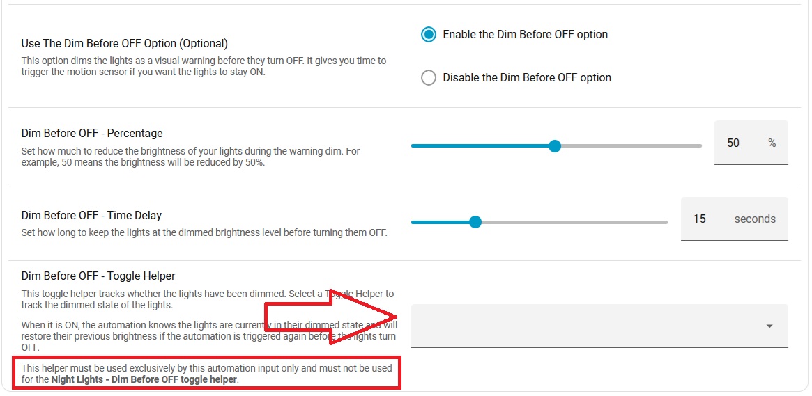

  1. Is there any way to have an entity pause the dim before off function. For example, having a TV light strip being on will pause the countdown and only will it restart once the light strip is off. I’ve tinkered around with the baypasses and state controls but they all just end up turning everything off once the strip turns off instead of just allowing the lights to stay on and the automation to return to normal from the countdown part.
  2. When using a motion sensor to activate a light, once the sensor stops detecting motion but the lights are still on, any kind of motion will cause the lights to raise up to 100% brightness for a moment before going to their desired state. Everything I have tried does not seem to help (from creating scenes in HA to setting specific brightness levels) and it seems to be directly tied to the sensor going from a no motion to motion detected state. If this is something that can be worked around through Sensor Light itself I’m not too sure but any insight into this would be brilliant.
Apologies for the long post but thanks again for all your efforts and hopefully you might have some clues on how I can get everything up and running!
@autom8-this
Welcome to the community.
  1. If you use bypass option 3 it will pause the automation or keep it in it’s current state. If the dim before option is active (lights dimmed) and you turn ON this bypass (TV light strip) the lights will resume the normal setting before it was dimmed. If you then turn OFF the bypass (TV light strip) the light will turn OFF… only if the motion sensor is clear. You do have an option to use the Bypass - Time Delay so if you motion sensor is clear it will wait for this delay before turning OFF the lights. If the motion sensor is active then the lights will stay ON or if the motion sensor becomes active in the Bypass - Time Delay period the light will stay ON.

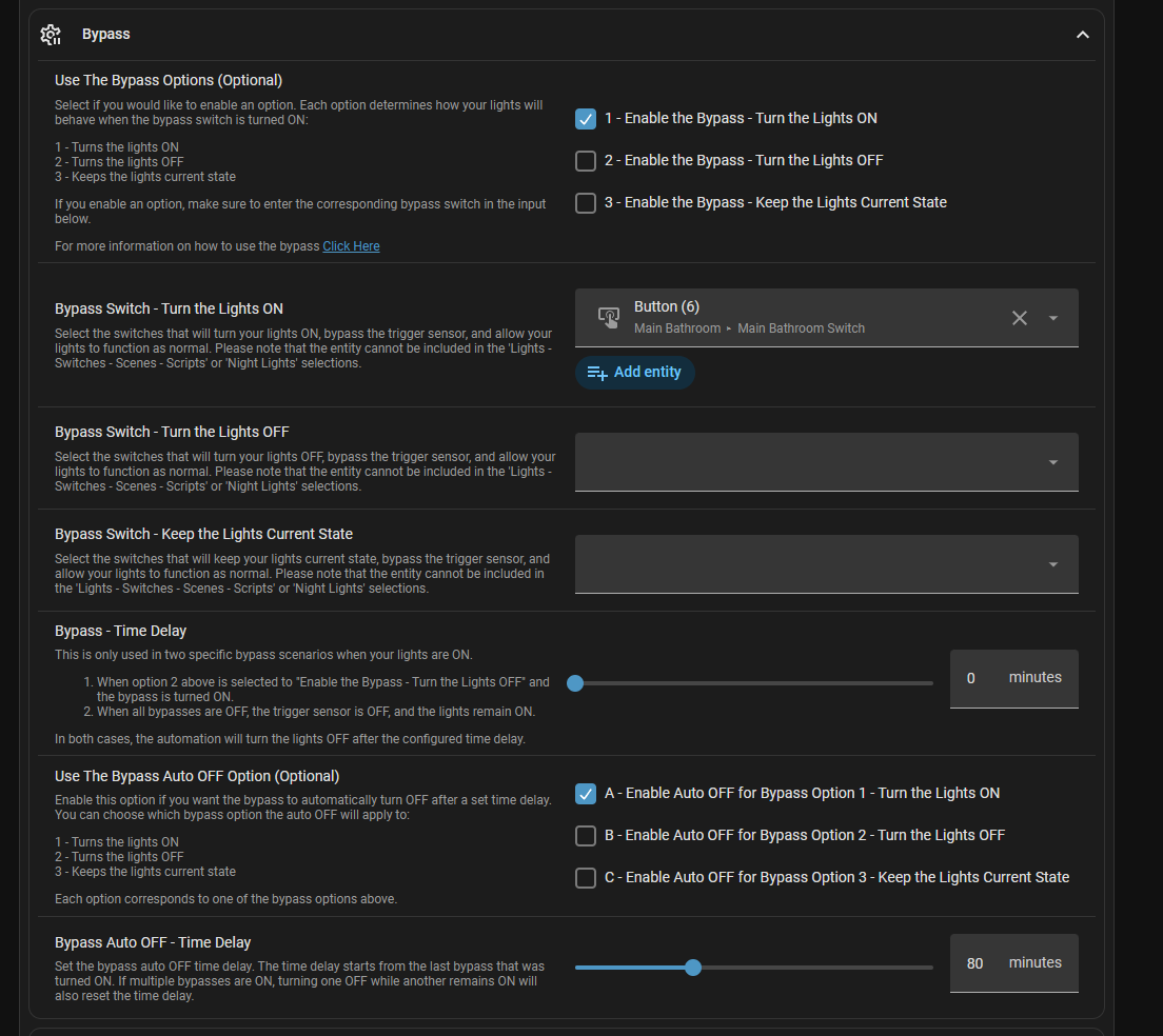

@Blacky I literally created an account here to thank you for your work on the blueprints and also to ask for a little advice, specifically regarding the Bypass function.
At first, after setting up the blueprint I couldn’t get anything to trigger, but after systematically disabling things I confirmed it was the bypass I had configured.
In a nutshell, I wanted a button on my IKEA smart switch to temporarily disable the motion activation and keep the lights on for the set period of time, before reverting back to normal. Here is a screenshot of what I configured:
Right now, everything is working if I turn the bypass off, but I can’t figure out where I’m going wrong with the settings here.
Below I’ve also included the YAML for the entire blueprint:

@TheRealDax
Thanks for your kind words.
The bypass must be a switch with an ON/OFF state, but you’ve selected a button.
A button only fires an event when it’s pressed… it doesn’t have an ON or OFF state. The automation needs to know whether the bypass is currently ON or OFF, so a button can’t be used directly.
The solution is to create a toggle helper:
  • Navigate to Settings > Devices & Services > Helpers .
  • Click the Helpers tab, then click + CREATE HELPER and select Toggle .
  • Give the helper a name (e.g., Family Bathroom Lights Bypass ) and click Save .
Now replace your button entity in the bypass input with this new toggle helper.
Next, download the :nazar_amulet: Press Button - Turn ON & OFF Entities blueprint. Configure it as follows:
  • Press Button: Your button entity.
  • Main Entity: The toggle helper you just created.
Now, whenever you press the button, it will toggle the helper ON or OFF, allowing the bypass to work correctly, including the Bypass Auto OFF Option . This works because the toggle helper has an ON/OFF state and automation can only turn a switch (or toggle helper) OFF… it can’t turn OFF a button.
Hope this helps you.
Blacky :smiley:
